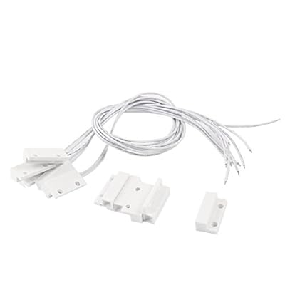

I cheated and used an open/closed sensor that had terminals for an external reed switch. The reed switch is triggered when the magnetic doorbell chime is actively being powered. I left the chime on, because of situations where other people might be present in the house, while i am not, and need to be alerted of someone at the door.

I’ll probably try this one. I’m in Canada so the other options are quite expensive. Thanks
