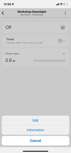

Can you let me see the log of what happens when you try to do a refresh in the app ? Make sure you set both the debuigging preferences to true.
Is the switch in decoupled mode or normal mode?
I sit set to wired or unwired?
Can you let me see what appears in the logs when you switch it on or off from the app? Make sure both debugging preferences are set to true.

If it is dropping off after 24 hours it may be because the link to the hub is too weak.
When you look at the details, as in the example from @Alvintham above, the last Hop RSSI number is an indication of the signal strength. It shouldn’t be too much below -60. Also the Route may tell you how the signal is being relayed to the hub.

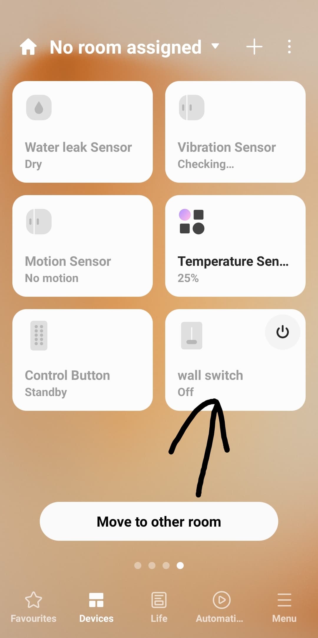

I have Aqura switch QBKG25LM 3 gung without nutral…
I contacted it to the HUB V. 3 successfully and then added your device habdler from github.
The problem is that I got only one gung in my app working fine with left phisical gong, while I should have 3 gung in the app… Would you please advise as I couldn’t find the answer in tge community…
Hi @hezqeel
QBKG25LM should work. Try doing a ‘refresh’ by opening the switch device putting your finger near the top and sliding down. It should create 2 other devices, which are for the other 2 switches.
