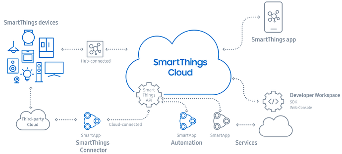

Arlo doesn’t seem to have a control to “Notify SmartThings”. I wish they did! They also don’t describe anywhere how their cameras notify SmartThings: is it a push or email notification. In either case, how does SmartThings know to look for it? What’s the mechanism? That’s what I don’t understand.
Normally this would be done through the SmartThings API. Arlo sends an Internet message in the right format, which anyone can do, smartthings knows that it has received this kind of message and based on the content acts on it. It’s pretty much the same method that Arlo would use to communicate with Alexa or another voice assistant, although the content format may be different.
That part shouldn’t be difficult: literally dozens of other companies do it, it’s how all the cloud to cloud integrations that you see in the smartthings app work.
Sometimes this method is modified for specific individual companies in order to add some extra features or reduce latency. For example, there’s a special integration of this type with Phillips hue. I don’t know if that was done for Arlo or not.
