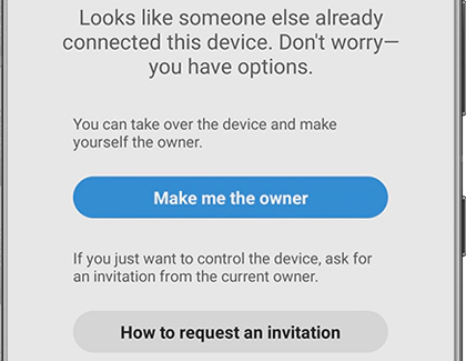

SmartThings capable appliances and devices are ready and available to onboard at any time. Even if you’ve got concerns that they might still be registered to their previous owner, physically having access to the appliance allows you to take ownership at any time. If the previous owner did not remove the device from their account, you should receive this prompt to make yourself the owner of the device. Did you receive the notification below when attempting to onboard the device?
Note: If you did not receive this prompt, this would indicate that a network reset of the device is needed to take ownership of the Home Appliance.
