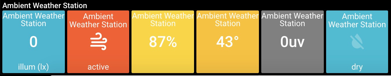

Thank you for your very well done directions. How do you get just the wind speed and UV index as a title in actiontiles?
Dear @carlk1956
Here are the exposed weather sensors in the Action Tiles builder screen and their mappings to the Ambient Weather Station V2’s tiles. Action Tiles only recognizes SmartThings standard sensors and does not recognize the other custom capabilities that the Ambient Weather Station can report in the SmartThings Tile. Please also refer to the “Using STAmbientWeather V2 with ActionTiles Application” section in the Ambient Weather Station V2 Readme document.
I also recommend using a WebCore Piston in Tiles Mode to show any/all the Ambient Weather Station V2 Tiles.
I screwed up and loaded the old device handler. Drove me crazy. So I started over and loaded V2. After reading your remarks kurtsanders would I be correct in saying that action tiles does not have the ability to show actual wind speed and UV index like webcore in an action tile?

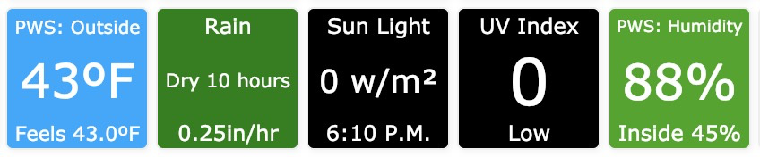

Dear @carlk1956,
Yes, you can. Please see the two ActionTiles I have pasted below for my local Ambient weather station data and overall city zipcode tiles. ActionTiles created a custom “weather” tile that you can use for your PWS data.
It then requires adding a new SmartThings Tile which ActionTiles can read. Please follow the “Using STAmbientWeather V2 with ActionTiles Application” section in my Ambient Weather Station V2 Readme document.
Got it and am now using the tile which updates only every 30 minutes. So the only way to show wind mph is to use ST’s preset SmartWeather Station Tile. There is no way to have a tile called MPH or UV that shows the actual reading.
