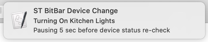

  2. Provide a MacOS right sidebar notification alert when:
  • Acknowledging a requested device change from the BitBar Menu Bar
  • Showing the timed device status refresh
  1. Allow user to turn On|Off MacOS sidebar notifications for routine status polling and device changes
  2. Provide an user defined automatic device refresh after a ST device change from BitBar Output (default 5 sec after device change which allows time for the device to report status to ST Cloud API)
