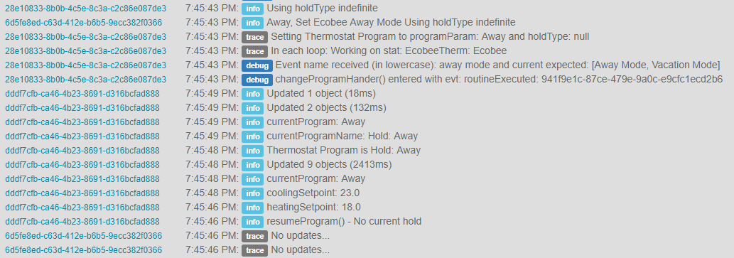

Ran the “away mode” routine that uses the Ecobee Suite Helper, then received the following error in Live Logging:
I selected “Away” in the app, and received the following error in Live Logging:
It appears to be the same error…any advice on where to go from here?

It appears that either Ecobee Suite Manager or Ecobee Thermostat did not initialize properly when installed. It could be as a result of the version of the thermostat you were running.
Now, this issue SHOULD have cleared itself within an hour of you installing the updated version, so you might find that it is working now. If not, you can try the “double refresh” trick to see if it clears up the issue - hit the refresh button on the thermostat device in SmartThings, wait for the Bee to re-appear, then hit it again. give it a few seconds (until the next scheduled refresh) then try changing programs again.
If that doesn’t work, there could be another error preventing Ecobee Suite Manager from sending the Programs List down to the thermostat. if you run Live Logging during the double refresh, you should look at the logs for both the Thermostat Device and the Suite Manager to see if any other errors are being reported. If so, send me the log snippets and I’ll see what I can do.
If there aren’t any errors being logged on the full (forced) refresh, I’m afraid you will indeed need to uninstall and re-install again. Here’s hoping that the problem has already cleared itself up :slight_smile:
I’m guessing the issue cleared itself within the hour, because I did nothing, ran it again and it works :slight_smile:

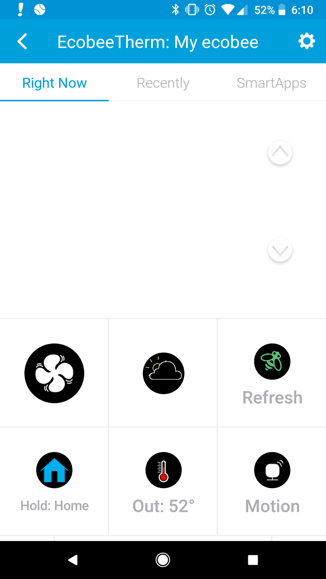

I just installed (for the first time) the latest version, and when operating in Fan Only, the top pane does not display a green background, but instead is completely blank. Running on android.
Odd…that shouldn’t happen.
A couple of questions:
  1. Does the Icon and Text “Fan Only” display in the top left Tile under the main tile?
  2. Did you try the “double Refresh” trick?
We need to look at Live Logging for the Thermostat Device to see if any errors are being logged. Could you please enable Live Logging, then do the double Refresh (hit refresh, wait for the Bee to reappear, then hit refresh again). Look in Live Logging for any red “error” entries - if any, please PM the surrounding segment of Live Logging (screen shot or text grab) to me…
Here’s a screenshot of device when running fan only. There are no errors in live logging for the device or smart app
Sorry, but I am travelling and without my Android device, so I pretty much can only ask questions in the quest to figure out what’s wrong.
  • What are the revision numbers for both the Suite Manager and the Thermostat Device?
  • What is the version of your Mobile SmartThings app?
  • Is this running on SmartThings Classic mobile app, or the new one?
  • Do you get the other colors (purple when idle, orange when heating, etc.), or is it only green?
  • Did you try double-refresh?
  • How about if you pull down on the whole page, does the display refresh?
You might try re-installing the Ecobee Thermostat Device in your IDE - something may have gotten messed up in the initial copy.
Since both the fan-on icon (above “Hold: Home”) and the main tile use the exact same variable’s state to define their content, I’m at a loss to explain why one works and the other doesn’t.
