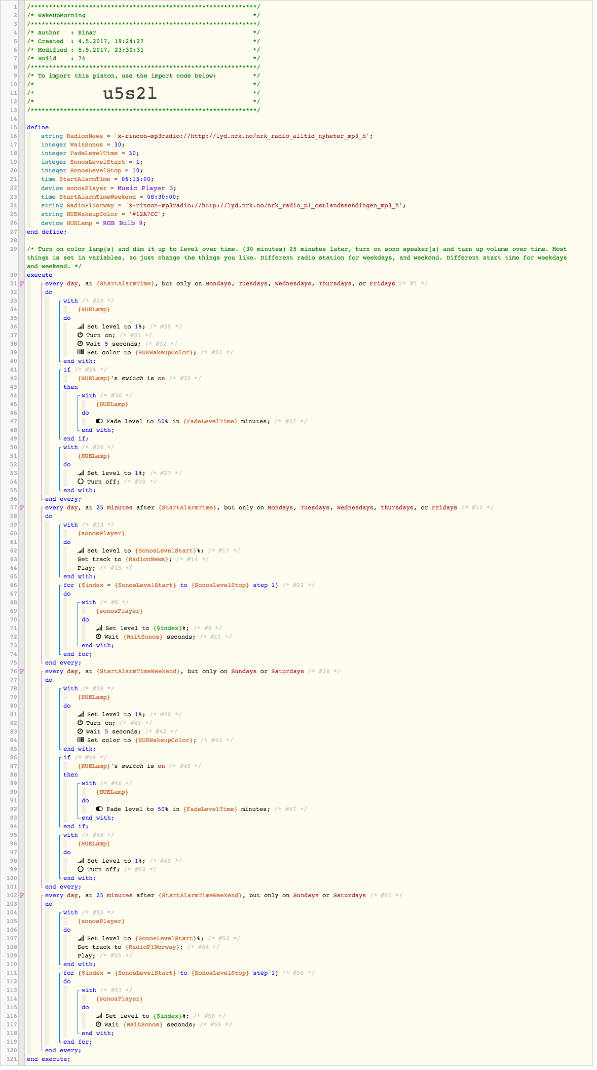

Wake up piston for mornings, weekdays and weekend.
Most things you could adjust in variables.
Created for Philips hue, and Sonos.
But like anything, its adjustable.
