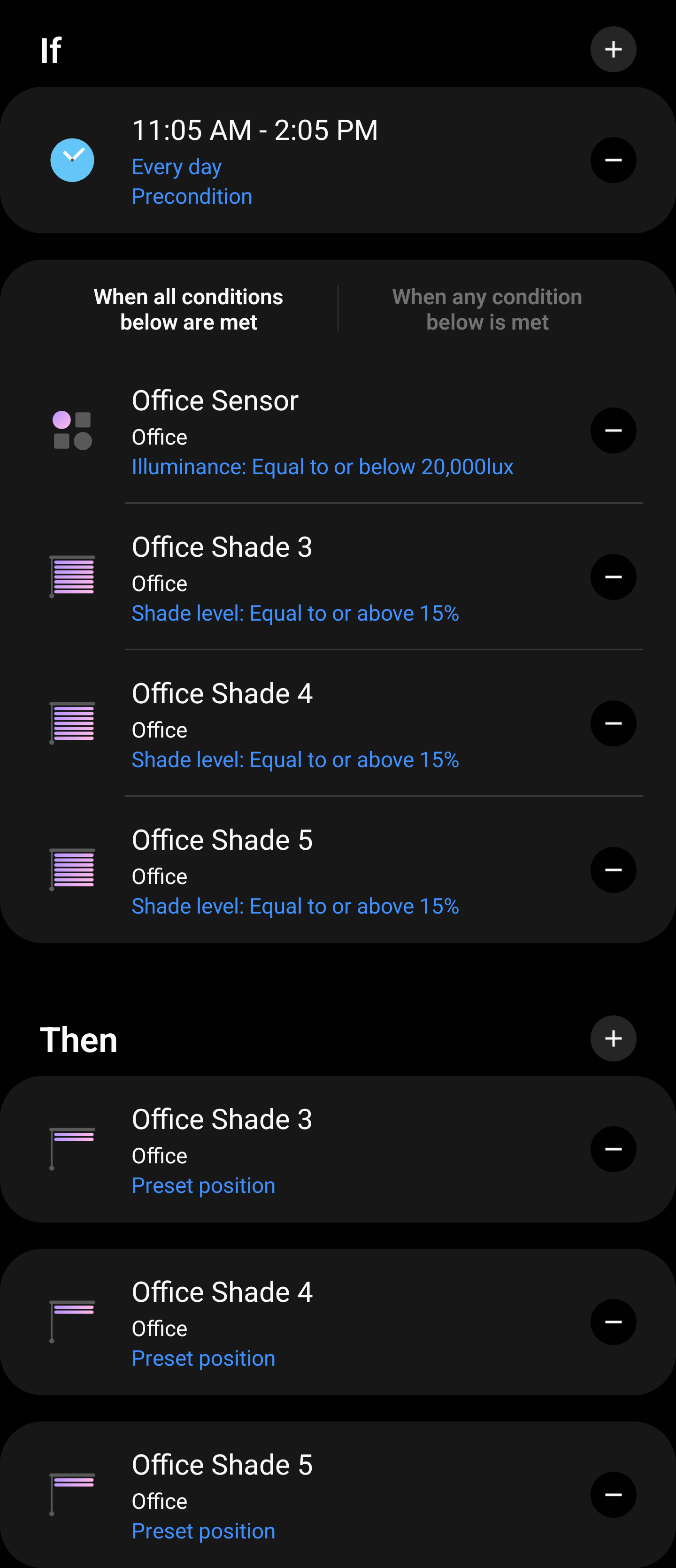

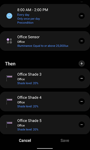

To provide more clarity, Routine 3 and 4 are similar in that they are time and lux based with Routine 4 also checking the shade level (so if you manually closed it completely it won’t execute). The exact config for these two routines are below.
Routine 3 (Always executes)
Routine 4 (Spotty Execution)
I’ve messed with the time range, lux levels, and the shade levels in Routine 4 but it doesn’t seem to always execute - even though the device history indicates the lux and shade levels are within the ranges during the time period.
