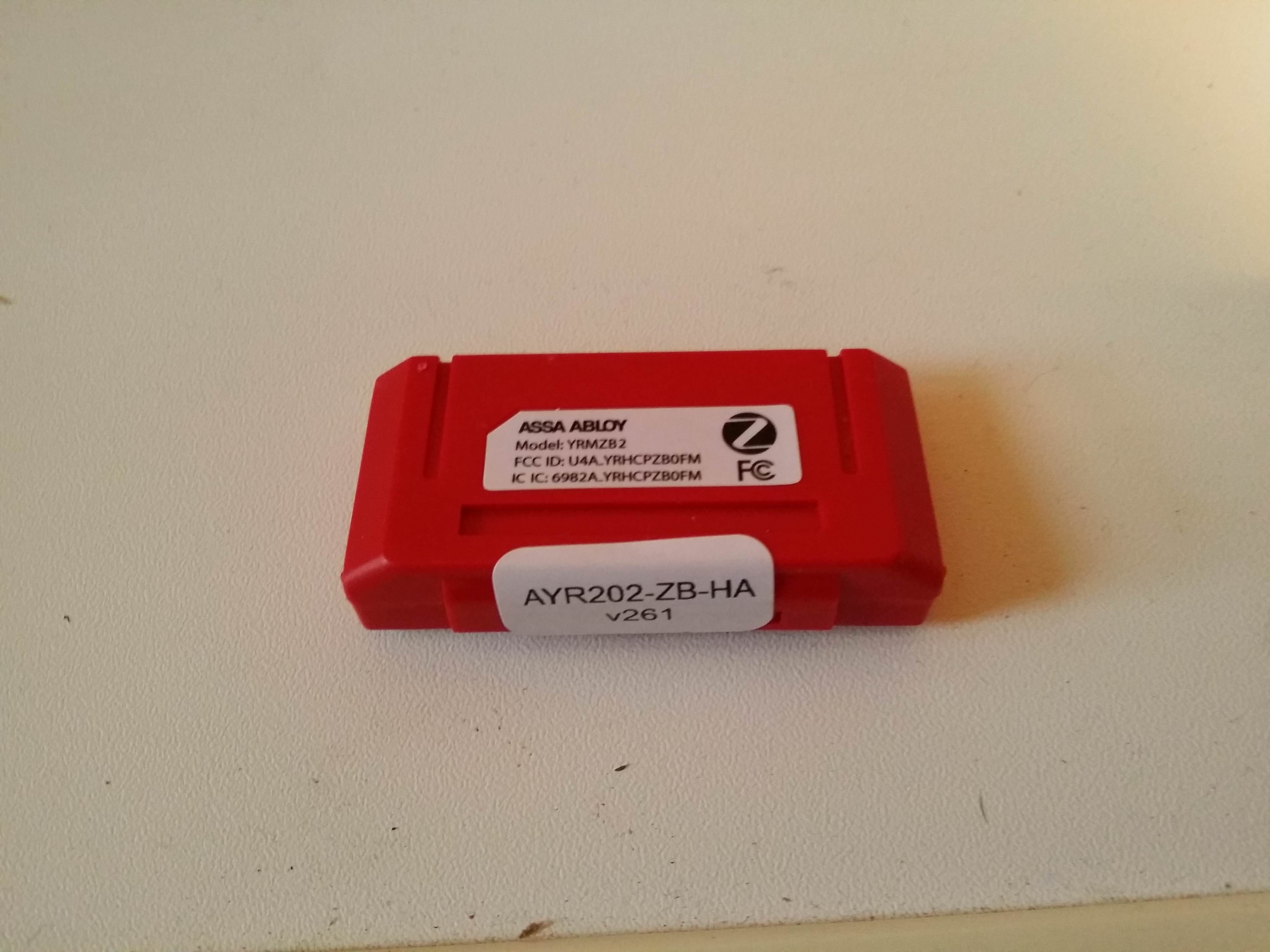

Just to update, I also bought 5 of the Yale YRD256 locks including Zigbee modules, from Amazon US. I have 4 of these working fine in Hubitat. The 5th seems to have an outdated Zigbee module. Although it has the same model number written on the module as the others, the version stickers on it are different. And although it does basic locking/unlocking, it does not report who has unlocked/locked correctly, doesn’t support a lock code manager, and keeps sending spurious Zigbee messages every minute. The other 4 modules all work as expected.

Can You maybe take and post pictures of the stickers?
I’m curious because I seem to have a middle version. Mine does locking/unlocking and it does report who has unlocked/locked, but the lock code manager always gives a error when I try to add a code.
Hi,
These are the stickers
The second one, with V261 sticker is the module that works fine in Hubitat.
Note that both modules also have identical stickers on the bottom side which state V258.
I dont know if there is a way to update the firmware on these modules.
