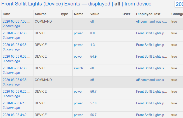

The two lights in the sunrise/sunset automation still went off early through:
Here’a something interesting that I just saw too. Looks like the automation ran twice, with the second one being the correct sunrise time. Odd. Check out the times on the screenshots compared to the ones above. The 7:33am state isn’t recorded in those above screenshots because it was already off:
What’s even more odd is the fact that there power values being reported between the off commands, but there was never an on command sent, or manually turned on.
