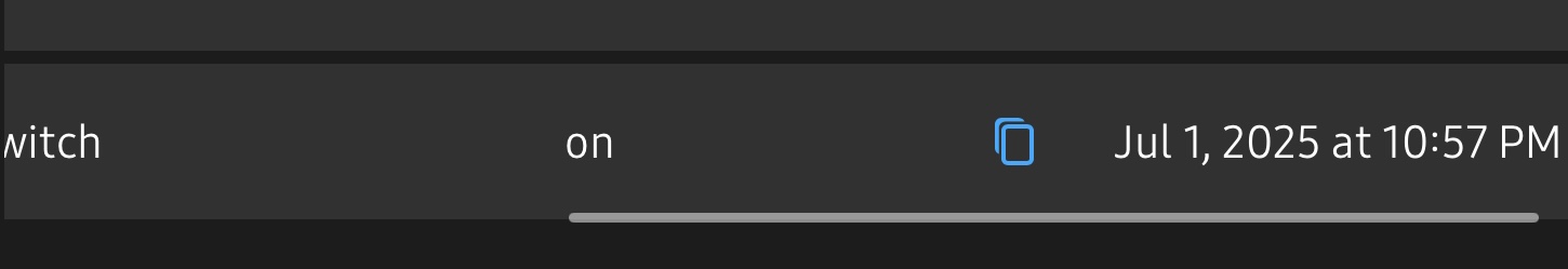

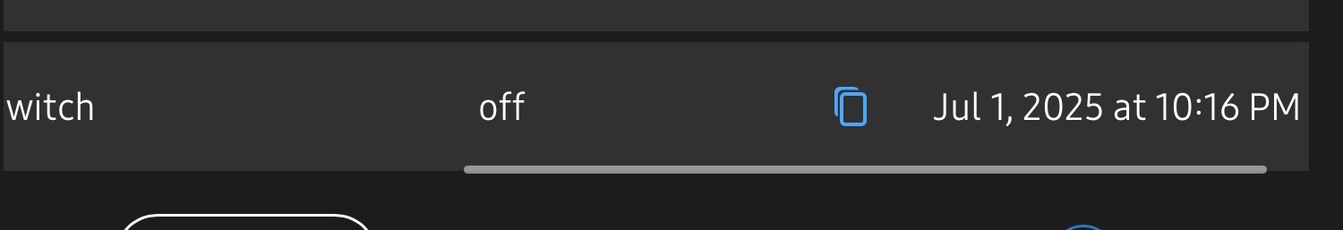

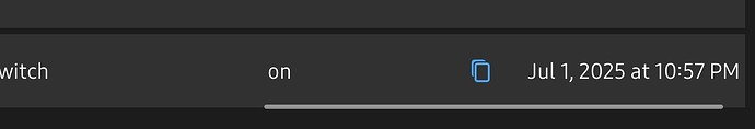

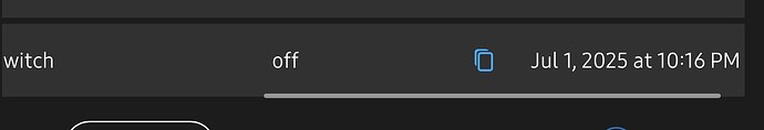

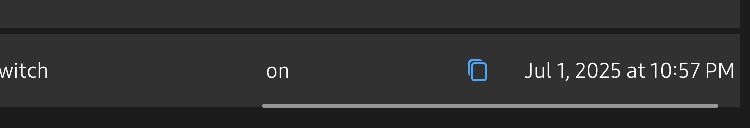

The last few days, devices are no longer properly reflecting/reporting their status. Eg, if I turn a switch off, the device will properly turn off, but when I look in at the device, it will report as either on or off (seemingly randomly) with no relation to the actual status of the device,
This is the case both in the mobile App and through the web portal. For the latter, it happens when I refresh the page; see the three screenshots attached, taken within a minute of each other, showing the same device flipping between on, off, & on again - the physical device was just on the whole time.

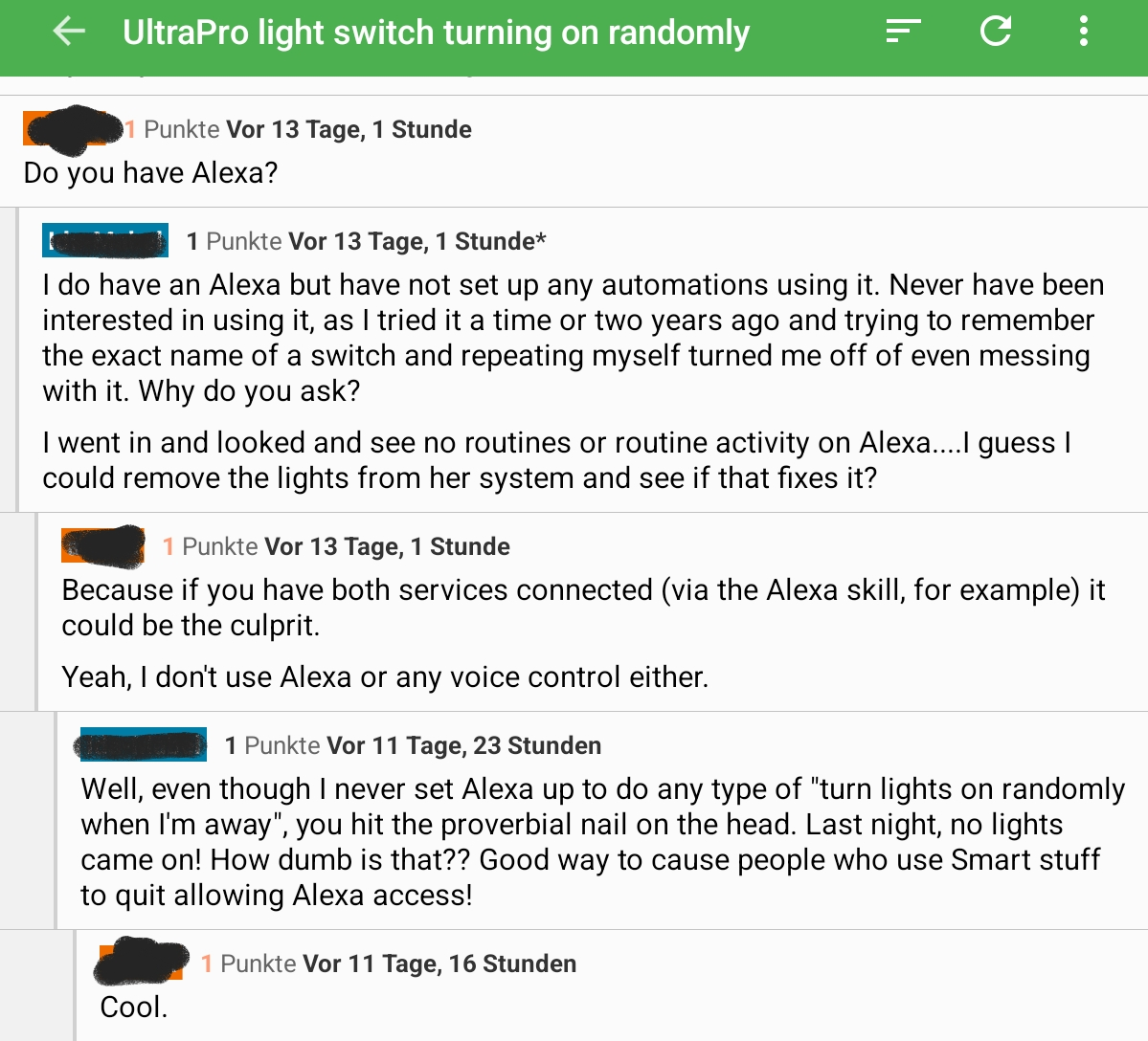

Do you have Alexa?

Thanks for the sparing a thought! To answer your questions, I have 2 Aeotec V3 hubs and the issue is affecting devices connected to both of them. It’s also affecting third-party WiFi devices that aren’t running through either of them.
And yeah I’m seeing the same behavior through the advanced web portal. That’s where those screenshots are from.
Have you noticed the timestamps though? The first and third are 10:57 but the middle one is 10:16.
So the API is not always returning the latest information for you.
Yeah, I noticed that too, but I have no idea what to do about it!

And I have a to ask again: do you have Alexa (connected)? I’m asking, because you’d not be the first with an issue like that…
I do not have Alexa.

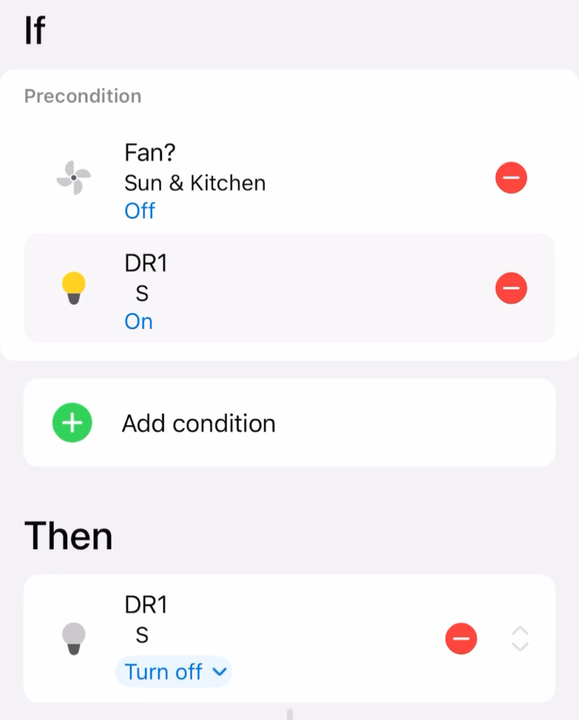

Ok, so to make this as simple as possible, I’m create a new simple routine, consisting of the following
Screen recording sent via email.
Obviously, what’s supposed to happen is that if “Fan?” is on, turning “DR1” on won’t trigger the routine (b/c “Fan?” being off is a precondition). But, as you can see in the recording, what is actually happening is that turning “DR1” on sometimes triggers the routine to fire, and sometimes doesn’t — presumably based on what status “Fan?” Happens to be flipped to at that precise moment.
Important background info is that the actual physical “Fan?” device was on throughout the recording.
Other info: 1) the relevant routine is named “DR1 Turn Off”; 2) relevant devices for this demonstration are “Fan?” (which is a Z-Wave switch connected to “Main Hub”) and “DR1” (which is a LAN WiFi bulb); 3) my time zone is CDT (UTC-5).
