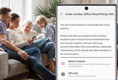

You should be able to invite him as a guest to your account, would that work for you? Or does he have other devices of his own that he controls through a smartthings app? Or do you have other devices that you don’t want him to have access to?
@jkp
Thanks I found it somehow and did it, finally, thank you :slightly_smiling_face:
