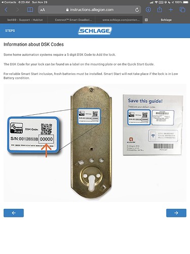

I am trying to connect Schlage Connect (Z-Wave) Lock (model BE489ZP) to Smartthings (using new Android app). Following Smartthings instructions, I am asked at one point to enter 5 digits of DSK code. I have no idea what this is and can not find it on a sticker attached to the device (neither I can’t find a QR code).

Did you try the scan nearby option? You may need to exclude it first.
Usually it’s a QR code on the surface of the lock that gets mounted to the door (gotta remove inside half of the lock), under the battery cover and/or a sticker in the instruction manual.
It is presented as a QR code, with the last five digits printed underneath it.
If the hub requires a DSK code to add the lock, you can find it on the label on the support plate or in the Schlage Connect Quick Start Guide.

I have seen screen print that you have attached. Unfortunately, the back of my devices does not have a sticker as shown on the left side. Instead, I have sticker as shown under “Save this guide” on the right side (the one with the barcode not with square Q/W code). I see model#, Serial number, programming codes and to other numbers without a description).

Hmmm… Can you check the model number again? The Schlage Connect is model 469. Model 489 is the Schlage Encode, which as far as I know is a Wi-Fi lock, not a Z-Wave lock, so it wouldn’t have a DSK code at all. :thinking:
The outer cases look very similar, but the internals are different.
JD,
You are correct, it is BE469ZP. I found DSK code and now I have Schlage connected to Smartthings.

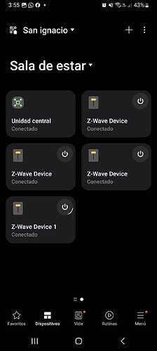

Hi eveyone, I have the same issue. I miss the DSK code, but when I skip that step the lock goes into ST as Zwave Device, and it doesn’t do anything.
What could I do, is there a way to get DSK code from the SN?
You have to pair it within a few feet of the hub. Exclude it and then pair it again right near the hub!
For Schlage locks, the QR code and printed DSK are typically on a sticker on the mounting plate behind the lock body.
