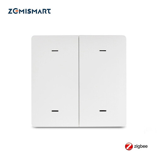

Are there any Zigbee 3.0 wireless wall switches on the market that play nice with the ST platform? Even better, models that can run locally?
Design-wise I’m thinking about something like these Aqara or Chinese off-brand switches with physical rocker buttons.

The tuya switches are sold under many different brand names, include Losonho and Zemismart. The first picture you posted is a tuya switch. But not Aqara. This does make a difference as far as the code you use.

These one look promising since they look similar to the old Xiaomi switches my household has gotten used to:
Just check to make sure that they are offering a smartthings DTH for the specific model you are interested in, they don’t for all models. :thinking:
That’s a good point. The Zenismart switch I liked didn’t come with a DTH, of course. :roll_eyes:
