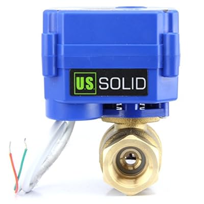

And a sturdy ball-valve, that wasn’t solenoid based and low voltage:
This valve has the added benefit of already having a 3/4" fitting (garden hose), and it closes automatically when it loses power. Opening time is about 3-4 seconds, so no water-hammer when it comes on. Also have a little wall-wart that gives power to this valve. Had one already, but you can get them for about $5 if you don’t have one. 12v/2A…standard little things.

I looked at those, but I was a bit leery of such things, since I’ve heard they had issues with water-hammer, and that the on/off pistons had issues after a season or two. That valve is pretty beefy…solid brass, two good O rings internally around the ball valve. Normally closed, so if it loses power, the water just shuts off.
Heck, given what most folks probably have lying around, if you already had a spare smart-outlet and a wall-wart, you’re done for about $40. I’m probably going to monkey around with the implementation of this, too.
Going to put an outlet box with GFC outlets into the box, with a plug on the end. And probably going to mount the valves with the brass fittings on the OUTSIDE, leaving the motor inside and covered. Keep the electronics dry and separated from any water/debris. I could probably fit at least 4 of those valves into one box that way, and at end of season, just open the box, unplug the outdoor cord, unscrew the hoses,and carry it all inside.
