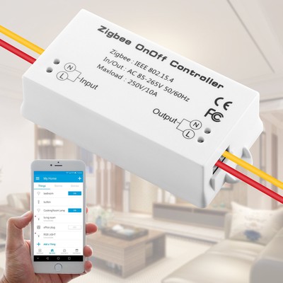

then I bought this switch:
now there are a few problems:
  1. when trying to pair the switch through ST classic- it’s recognised in auto search mode as ,THING’ and I can’t add it to any automation.i can add only my smart tv as a device to work with. the switch is not showing there. when clicking on THING switch- it said: please wait
  2. when I use ST app- it cant find the device at all in auto mode but can pair it if I choose manual mode-sensors-switchers and dimmers- any name there. any way afterwards ST said: cannot connect to device despite its connected. the switch itself shows me that its reacting to pairing process
    I heard something about Device Handler but have no idea what to do there. this switch is visible there.that’s what i see on that page:
    could you give me a piece of advice- what to do next. or may be advice me of any simple 220v switch that would definitely work with new v3 hub?
You’re on the right track.
Go back to the device page and click edit and you should see the drop down box to change the device handler.
In there you should have a ZigBee switch select that and save and then go back to your Smartthings app to see if it’s working if not go back and change it to another.
A default one should work but you may need a custom device handler for it I’m not sure as I don’t know that device.
