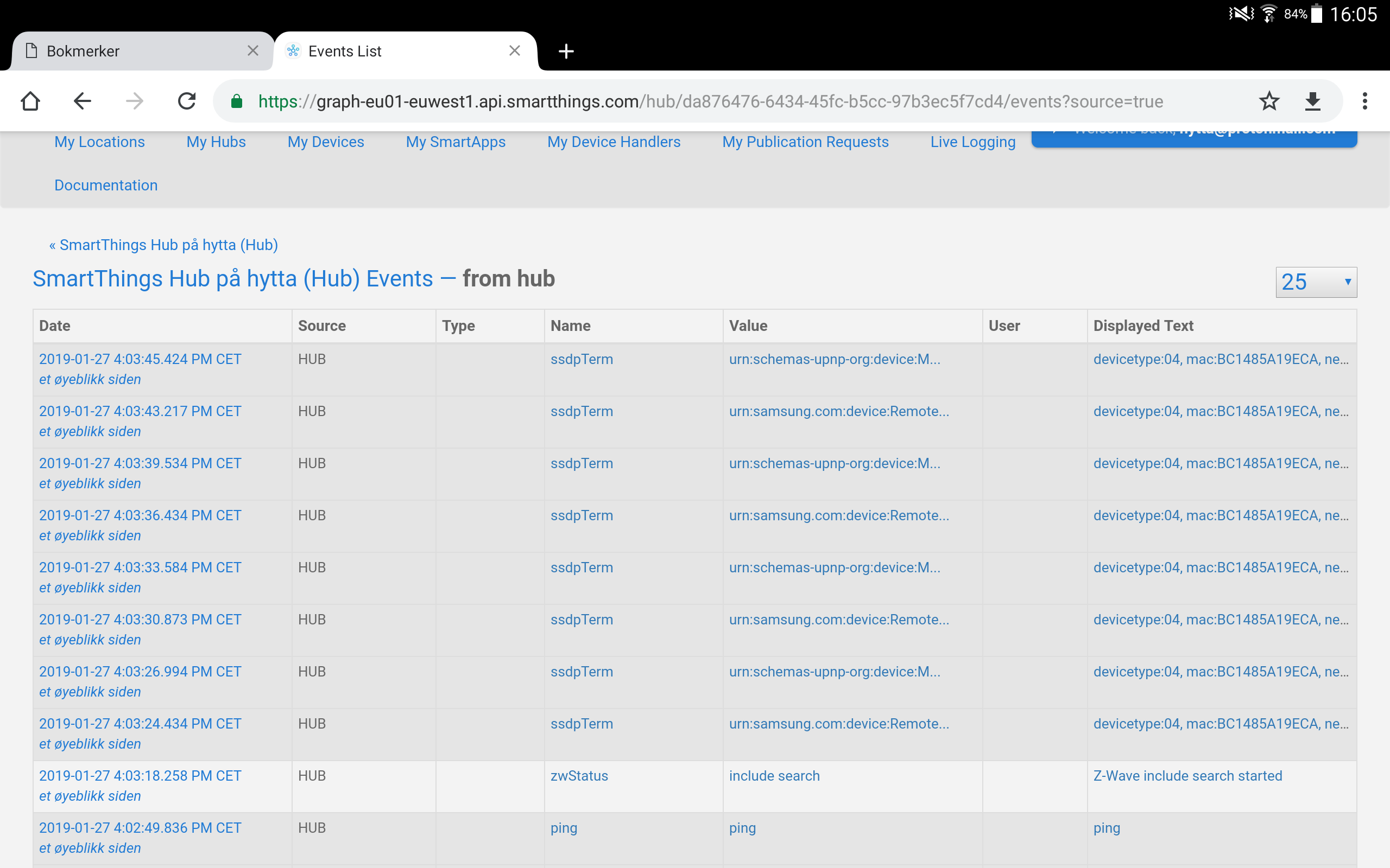

Are you familiar with “List Events” in the Hub tab of the IDE? I would repeat the exclusion, reset and inclusion while looking at that event list. You should see logs related to what you are doing and it might provide some insight on what the issue is. I have the same motion sensor and I use a custom DTH for it… I wonder whether there is a standard ST DTH for it, and if not, whether it could be part of the issue. It was my understanding that it would still try to pair but just be reported as a generic device if there was no DTH for it.

The IDE is a website, not the app. The link below will take you to the correct shard:
https://account.smartthings.com
Should take you here:
Under Location you should have “Home” unless you changed the name. If you have more than one, let me know.
Under My Hubs, you should see a single active hub. Towards the bottom of the hub information you will see Events List. That is where you can see what is actually happening on the hub. Issue is the messages are far from user friendly.
Check under My Devices to see what devices are paired with your hub.
Mine shows this info (name is generic as I am not currently using it for anything):
If you have not seen this site, then please familiarize with it as it will be likely necessary at some point (if not now).
I found it…seems to me that the motion sensor is not sending anything ?
You might need to hit the refresh button to keep loading new events. Since you have the exact time (see screenshot) of when you were doing the test you can go back to take a second look.
