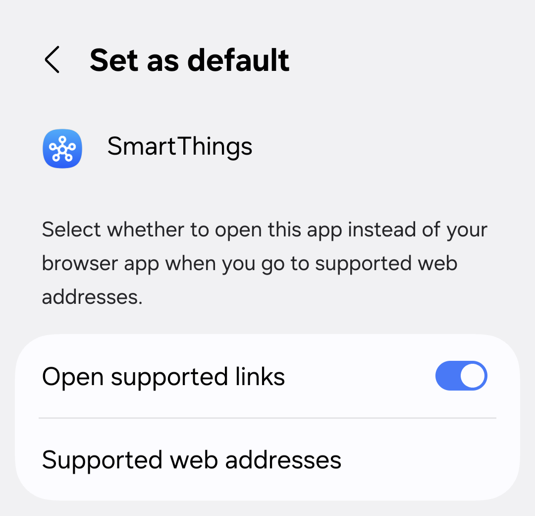

If you are running Android I would suggest checking the app settings for SmartThings (in Android, not within the app). Specifically the defaults:
You need the supported links to be handled in the app:
If you are using iOS then you need the equivalent. I forget the buzz words.
The bottom line is that when the app receives a redirect to e.g. https://c2c-us.smartthings.com/ it should be handling it internally not looking for an external site in a browser.

Thank you for the suggestions, I checked and the App defaults are enabled and the correct URL is one of the defaults. I am using Android but it still is opening chrome browser with “{}”. my logs show that discovery is not getting triggered from Smartthings.
