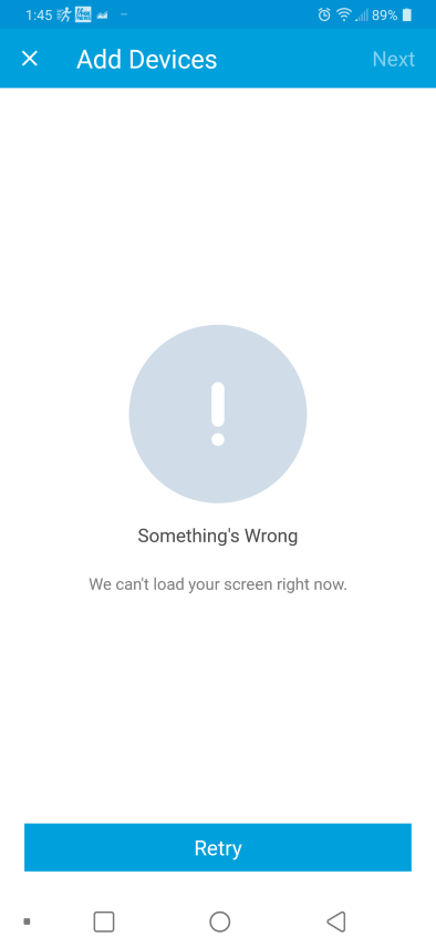

I have tried several times to create a scene in the Android version of the mobile app. I get the Message:
Something’s Wrong
We can’t load your screen right now.
Any suggestions?

Which android app? Classic or new? (Circle or flower icon)
Classic. Everything else in the app seems to work fine. When I touch “Add a Scene” it switches to the “Add Devices” screen and then reports the error a few seconds later.

@Brad_ST. I am having this exact issue. I touch “Add a Scene” and get the something’s wrong screen.
Any idea what the problem might be?
The app is trying to load a high number of devices and is timing out. Do you see this behavior if you try to create a scene in the new app?
I do not see this behavior in the new app, just the Classic app. I don’t often use the new app. I do have a lot of devices though.
Understood. I don’t know if or when that error will be addressed in the Classic app unfortunately.
