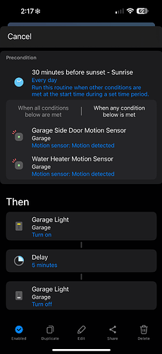

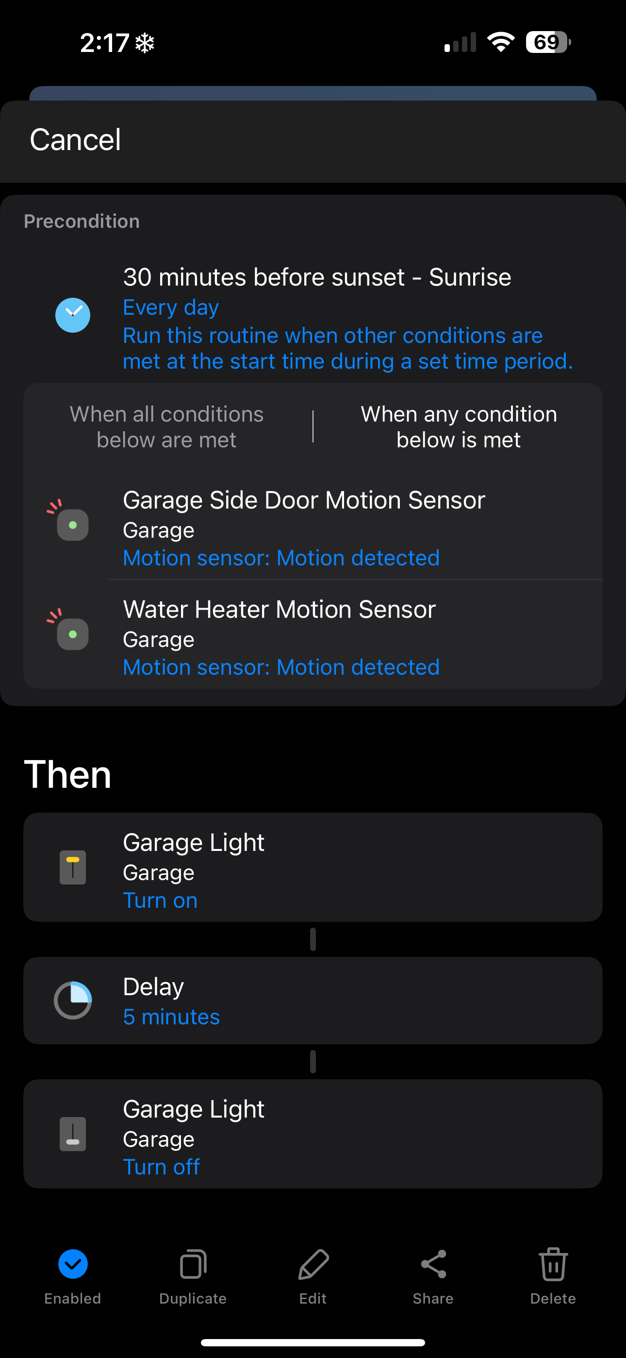

I am trying to create a simple routine to turn on the inside garage light when one of two motion sensors in garage detects motion. And I want to add couple of conditions:
  1. that this only happens from 30 minutes before sunset to sunrise.
  2. turn off the garage light after 5 minutes
When I tried to create this routine, I ran into an issue with setting the Time Period. Whenever I set the offset to X minutes ‘Before’, it automatically changes to ‘After’.
For example, when I select Time Period, then select ‘Night’, and choose ‘Sunset’, I change the Minutes to 30 and select ‘Before’, but as soon as I do that, the ‘Before’ is automatically changed to ‘After’.
So basically, I can’t set the offset to 30 minutes before sunset. I can only set it to sunset or some minutes after sunset but not before.
This has to be a bug?
I got the routine working by using the APP’s AI assistant by just typing in what I wanted and it seems to be working. But even then, when I go into this routine and see the Time Period, it does not have the proper offset. I’m not sure how this routine is working properly even though the Time Period doesn’t seem to be set correctly.
