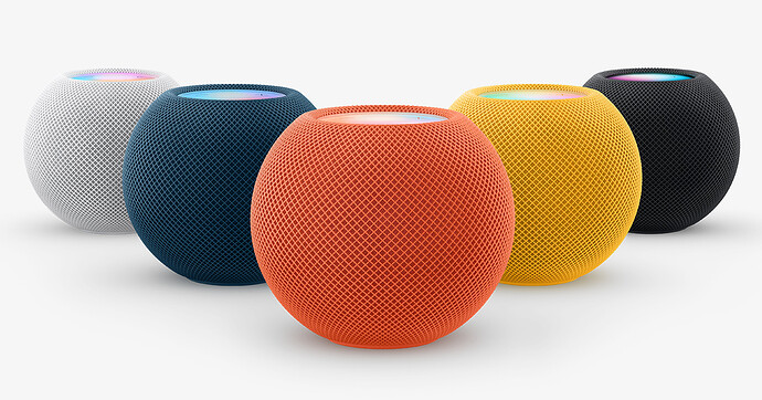

HOMEKIT AUTOMATIONS require a HomeKit hub
If you don’t already have HomeKit set up, you will need something to act as a hub. It can be an iPad which is always plugged in at home, an Apple TV 4, or a HomePod mini. If you don’t already have one of those, I recommend the $99 HomePod mini, which is Apple‘s smart speaker.
Amazon doesn’t carry it because it’s an echo dot competitor, but you can get it at Best Buy, Apple, or sometimes Target.
It’s $99 at Apple or target and $99.99 at Best Buy, but of course you may belong to a discount program that affects your store selection as well. Otherwise it doesn’t matter where you buy it.
