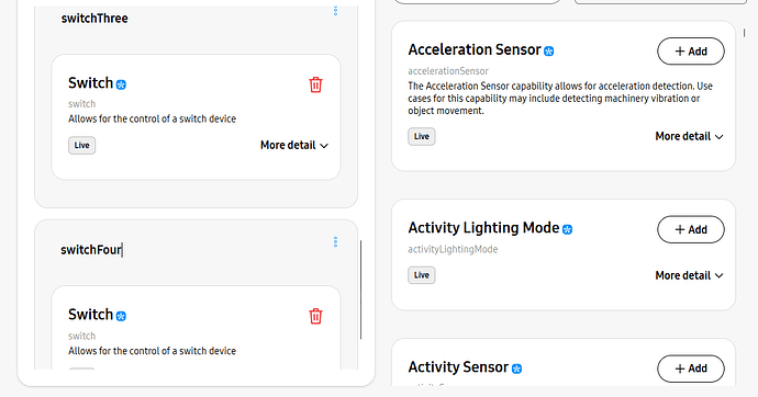

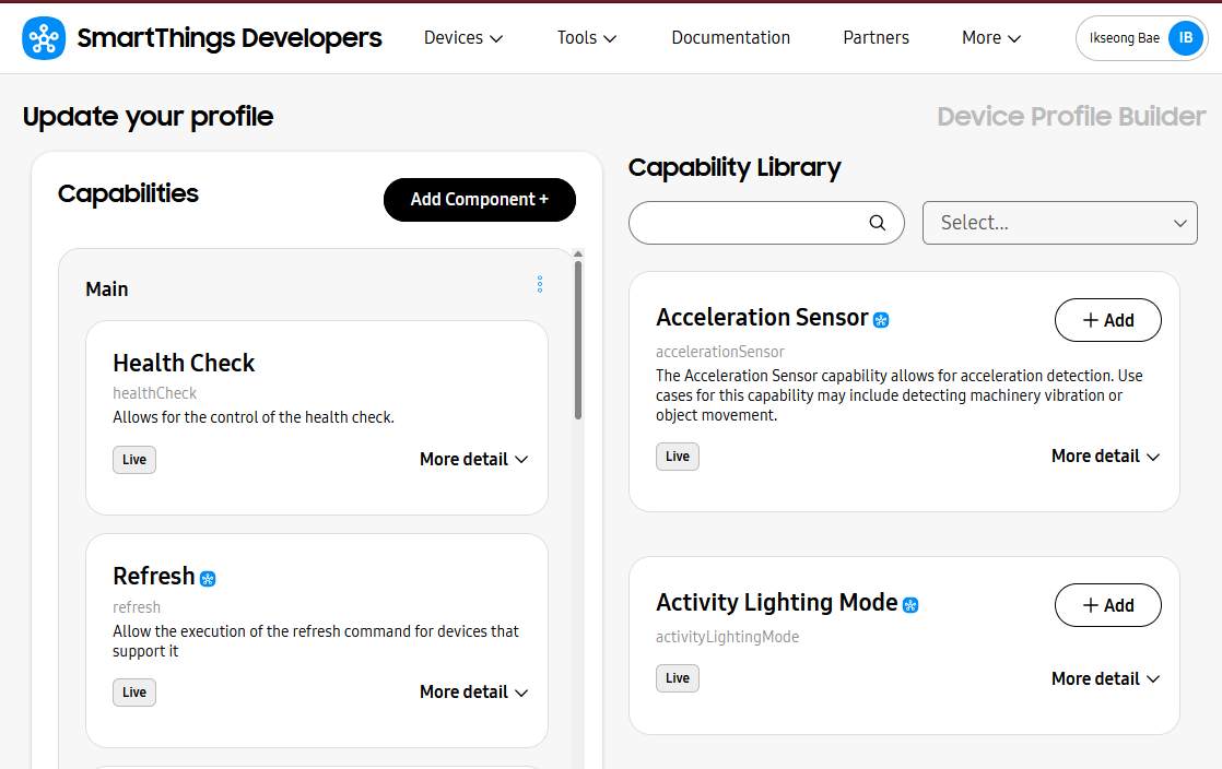

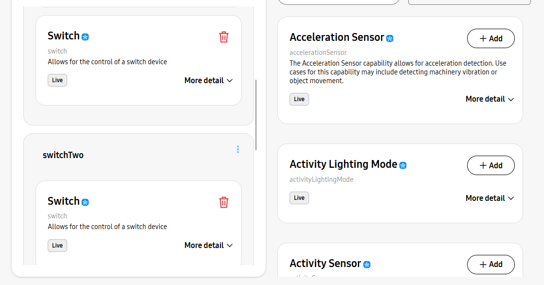

According to the documentation, this should display four switches grouped in the SmartThings app dashboard.
However, when I actually create a device profile using the Device Profile Builder, download the JSON, and test it, only a single switch icon appears on the dashboard.

So my questions are:
  • Is it currently not possible to implement multi-component devices properly through the Device Profile Builder?
  • Do we instead need to manually create the JSON files using the SmartThings CLI?
  • Or is this simply a case where the documentation has not yet been updated to reflect the latest changes?
Any insights or experiences from other developers would be greatly appreciated.
We reviewed the presentation of your profile and those values are not appearing. It’s possible that they were not saved correctly or that you received an error during the process. Could you please send us the file by email at ** build@smartthings.com** so we can validate it?
Also, did you create the profile from scratch, or had you already installed it at least once before? If the latter, that could be the cause, as the presentation may not be refreshing after that.
