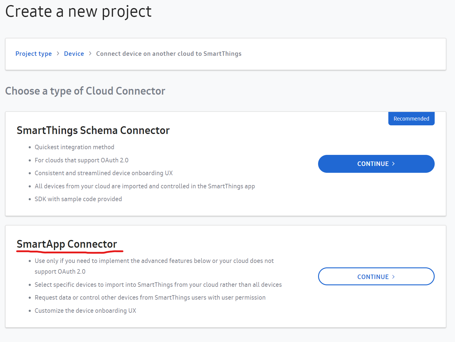

Was the original query ever resolved? I have the same problem in that there is no obvious link in the workspace to create a device profile when creating a schema connector.
We are working on making device profiles more easily accessible, but for now you will have to create a new C2C project under “SmartApp Connector” at which point you will see the Device Profiles tab. You can then use that device profile in Schema Connector. The Developer Workspace team is working on making this process more developer friendly.
Thanks, I will give that a go.
