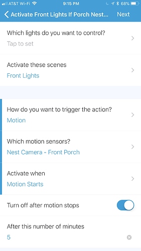

I was successfully able to install NST Manager today and was looking to use my Nest Outdoor cam as a motion sensor to trigger my front exterior lights. What am I missing?
Because of timing of events between NST Manager and Nest, the motion event is not recorded in NST Manager (day late and a dollar short). You have two options:
* Run the REST streaming service for NST Manager (real time events)
* Or use IFTTT (pretty close to real time based on the trigger service)
I’m going to refer you to a post that I just made for someone else who had a separate question based on something I posted 5 days ago in this thread. If you go down 3/4 of that post, it addresses the REST and IFTTT and how I’m doing this now:
Thanks for the reply @WB70, I tried using IFTTT, I can get it to trigger the lights to turn on with motion but I would also like it to turn off after 5 minutes of no motion. Were you able to add a delay on the IFTTT recipe?
IFTTT should only be used for Nest as a Trigger Service for person event on a notification received, and then action service to turn on a virtual switch in ST instead of a light.
Create a Piston in webCoRE when that virtual switch is turned on, turn on the light, wait 5 minutes, then turn off light and virtual switch.
  • By having the virtual switch, you can do other things as well in addition to turning on a light as well such as sounding an alarm, playing an audio notification on a speaker. This gives you flexibility later when you want to add additional actions.

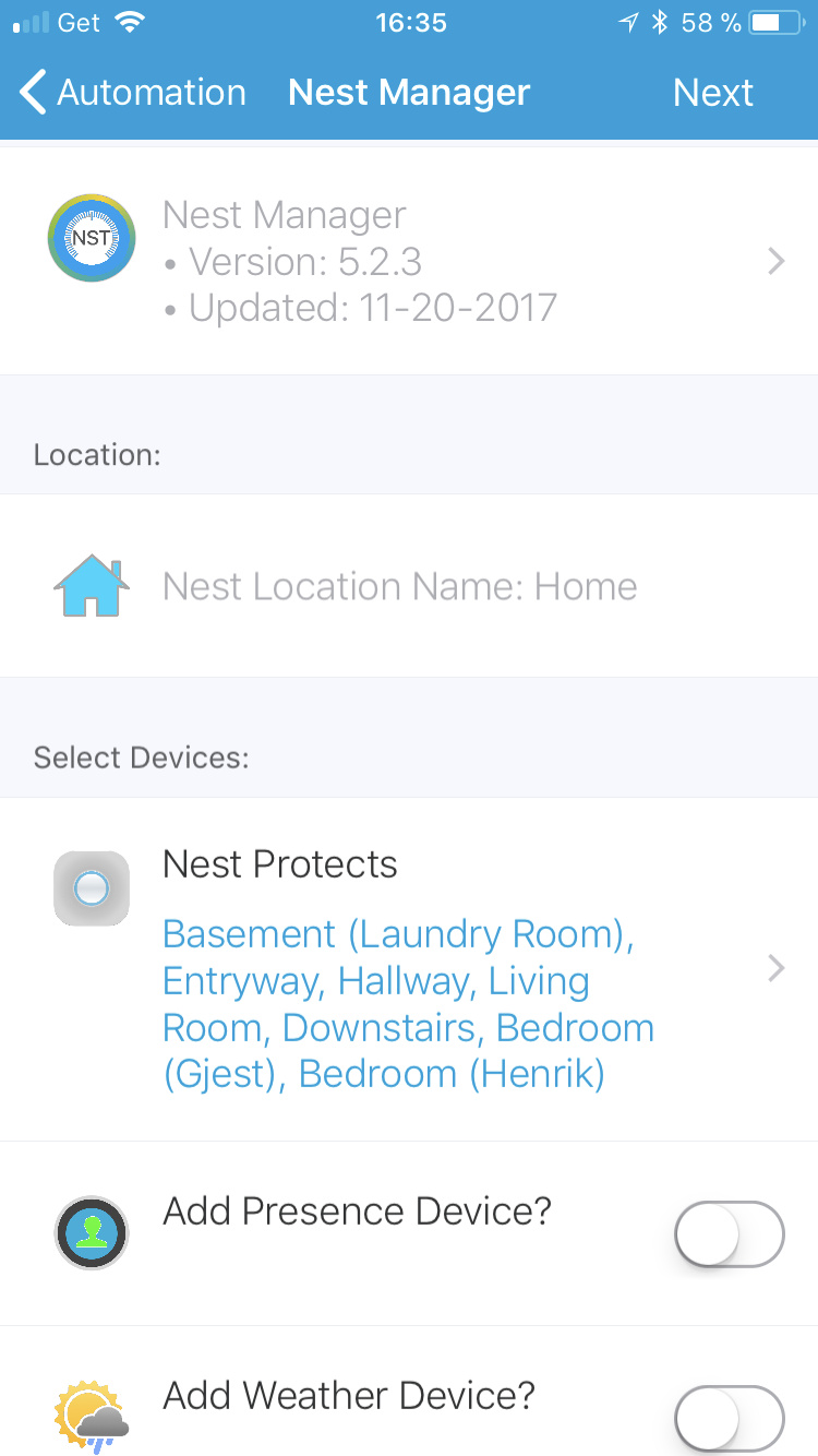

I had this smartapp and it was working fine with the provided tokens. Noticed now when I was going to add a new protect that they had not been update for a very long time. So I removed everything and startet over. Everything seems to be ok, I did not get any errors or something, and Im able to find all mye devices and select them.
But the problem is that it does not actually add any devices when I installed the smartapp. There is no errors on the mobile app or in the live log. Tried selecting the protects, weather device and presence device. Nothing comes up in the “Things” list. I’m on the latest version of the smartapp and all the DTH’s
If you successfully authenticated to Nest, after you installed, then you would add each of your devices from the main screen of the NST Manager SmartApp in Automation / SmartApps.
Share a screenshot of your main page when you open Nest Manager. It shows your Nest Location and Home/Away Assist status.
It finds all my devices, but does not actually add any devices when I finish the installation
Go over to your Nest Application. Do you have any new messages at the top of the app?
If you do, open the most recent one, scroll down and click allow.
Also, go into works with nest. Do you see your SmartThings product you created? Open it. Does it say added by you?
