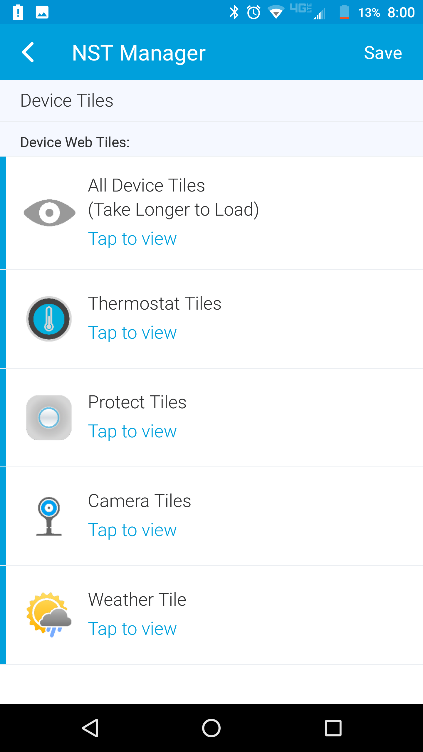

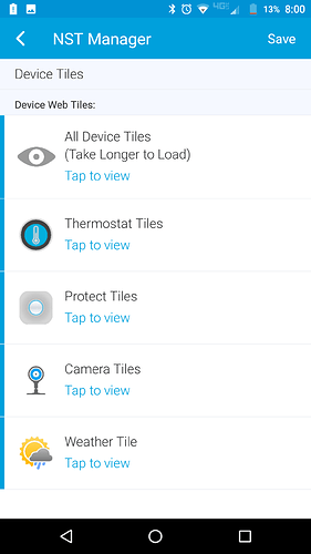

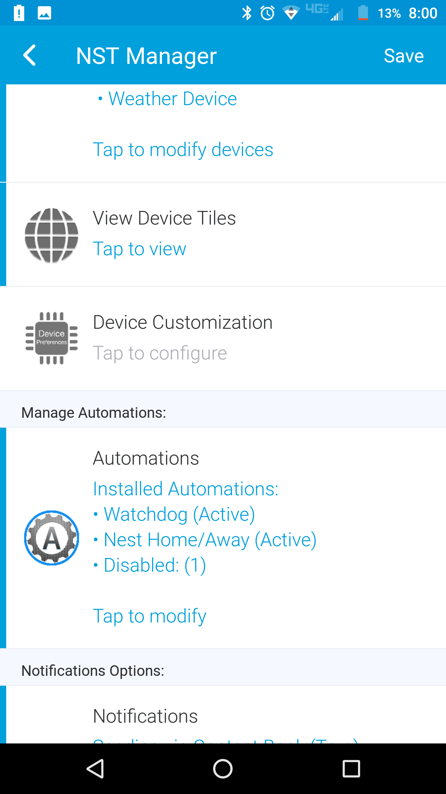

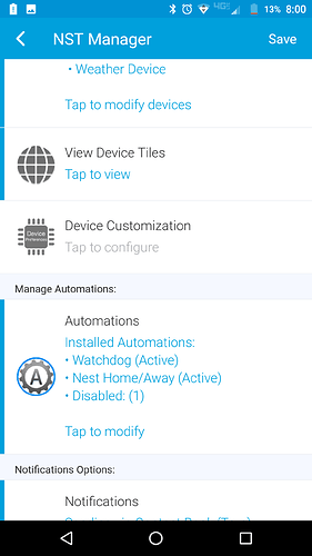

That same information is available 100% of the time if you open NST Manager and click on View Device Tiles:
@WB70 Yes I have seen that and it does work all the time or at least the times I have been in there with no problems. I’m much rather just go there if needed rather than having it show up on the main screen where it does not work

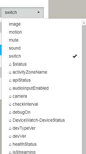

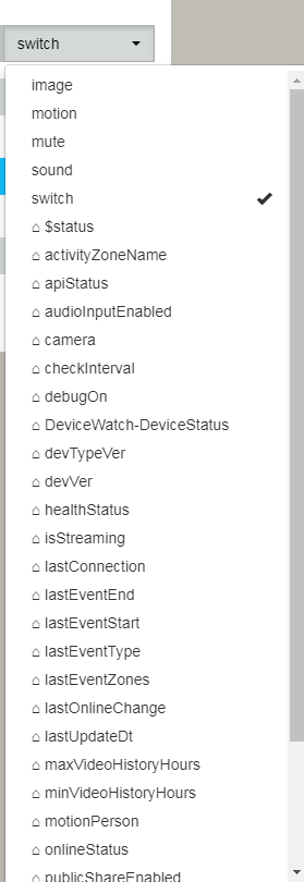

Trying to create a simple tile in webcore which will let me know if my nest indoor cam is on/off. I usually turn it off when I am home and expect to turn back on when mode changes to Away.
What should I select from following categories which will let me know if camera is streaming/on or notstreaming/off.
I could be wrong, but I believe it is “isStreaming”, values “on” and “off”
EDIT: I tested and confirmed with a Piston that the above is indeed correct.
Maybe I am too impatient. “isStreaming = on” is working for me but “isStreaming = off” is not working.

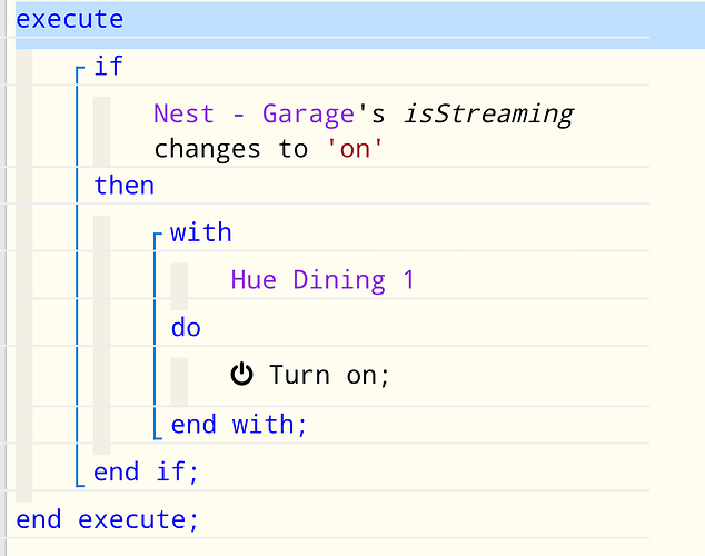

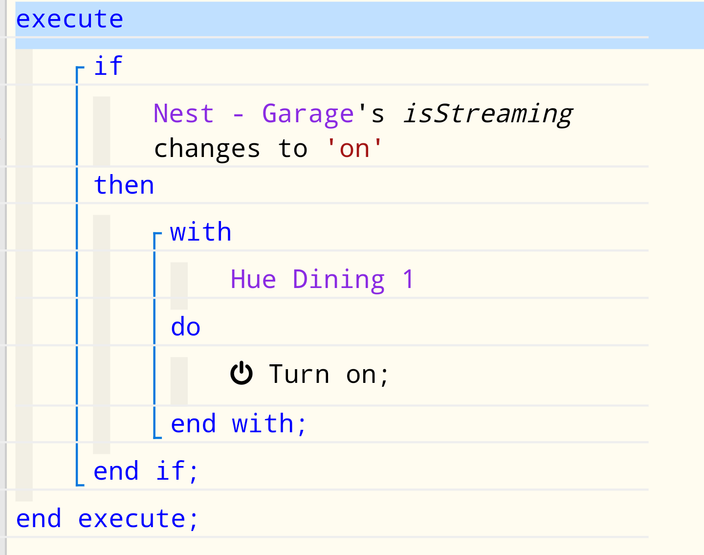

Both on and off worked for me. I edited the same Piston for on and then off to turn on a light as shown below:

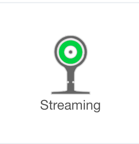

To test, open your camera in the mobile app and simply press the little camera image, not the Active / Inactive picture
Screenshot_20180327-123205~2
The labels in your device show Streaming and Off, but I validated that the correct values in the DH are on and off and they both work appropriately in webCoRE.
If you test the way I described, your test will be almost instant.
Its working now. My original piston was (forcefully) turning it on since the mode was away. But I paused that piston and started from scratch and it is working now. Trigger is instant as you said. Thank you.

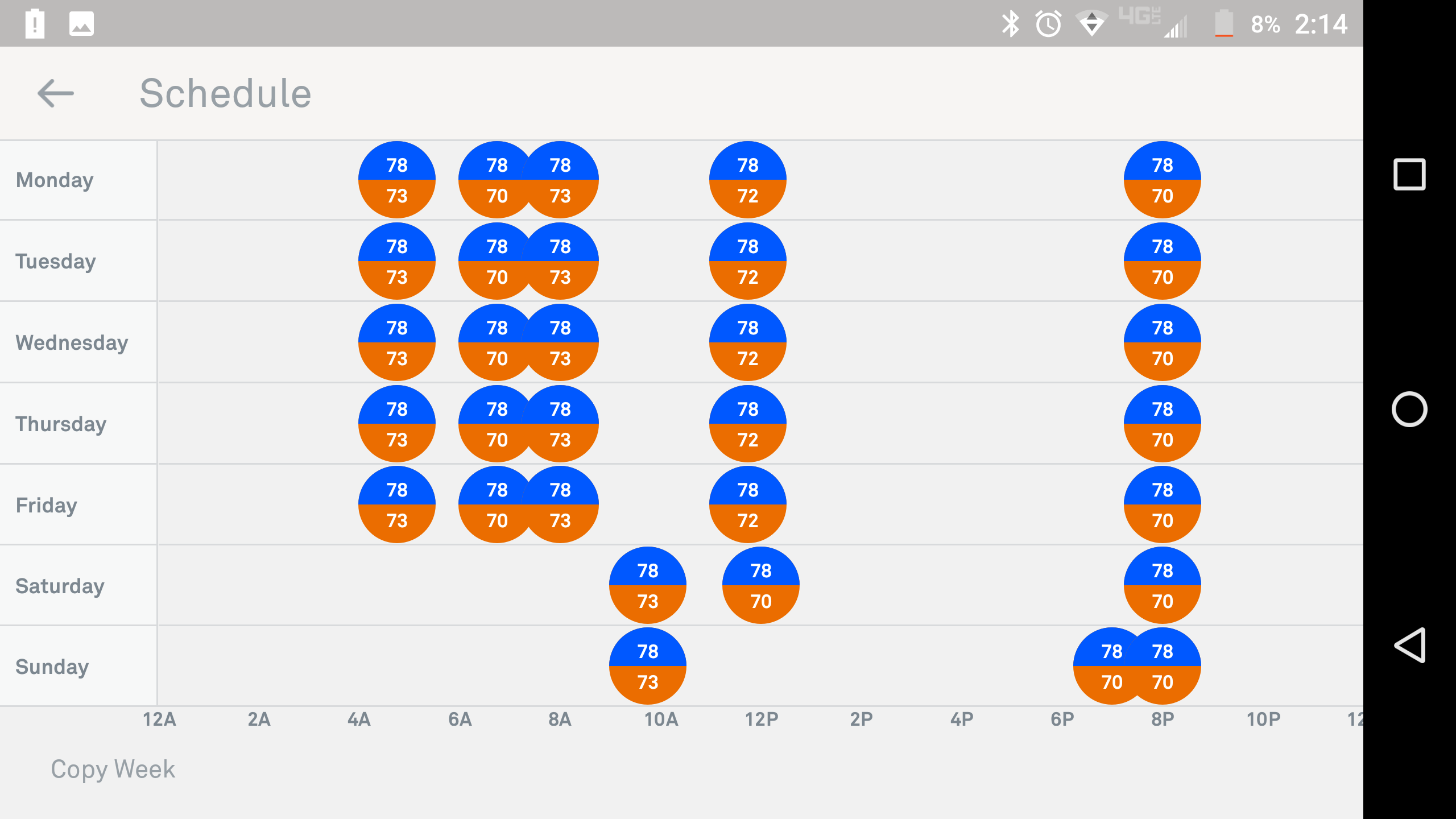

Quick question. I run my Automation schedules through NST manager, and over the course of the last year have tweaked them occasionally. That said, from time to time it seems like old temp setpoints that I no longer use get sent to the Stat. Is this something that Nest has learned and I need to delete some sort of cache perhaps? It’s not a huge issue, just always looking to make things run as smooth as possible.
Numerically, let’s say for a few months it ran on auto between 70-73 from sunset to sunrise, but now I’ve had it widened to auto 65-75, occasionally I will catch it in the logs as having set the Stat to 70-73 still for some reason. I don’t see any conflicts in my scheduling kind of scratching my head.
Thanks!

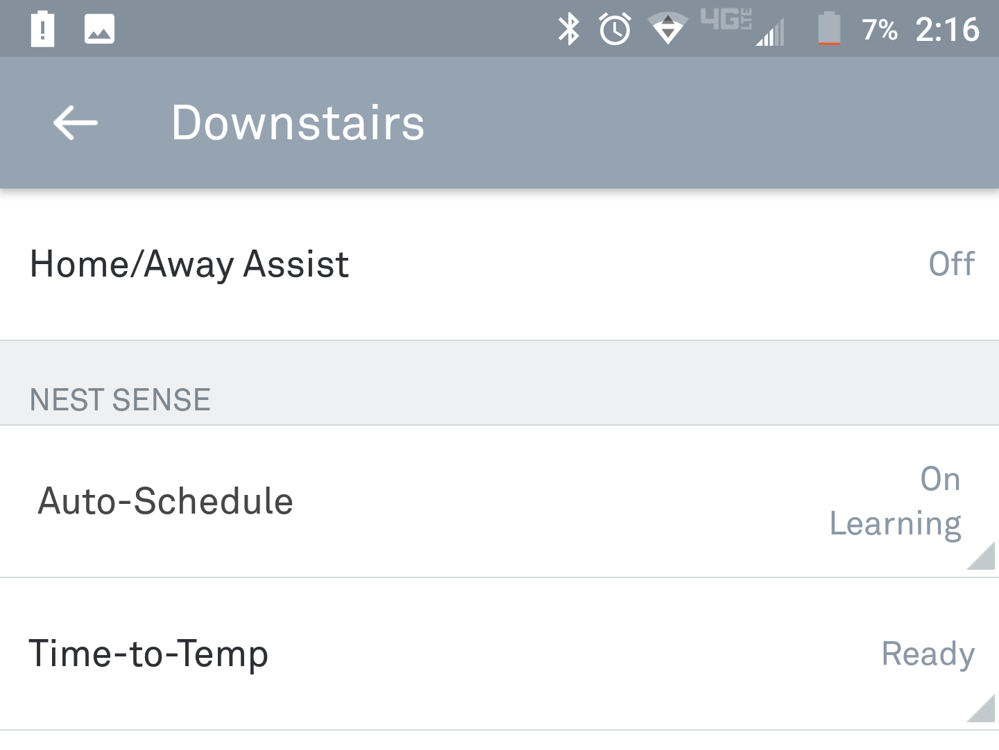

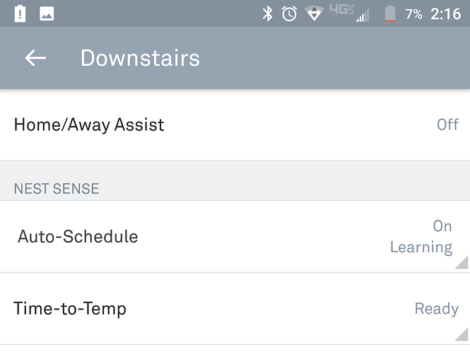

If you open the Nest App and select your Thermostat and then click on Schedule, do you have any set schedules in there?
And if you do have any schedules that show up, if you click on the Gear icon, is the Auto-Schedule On/Learning?
