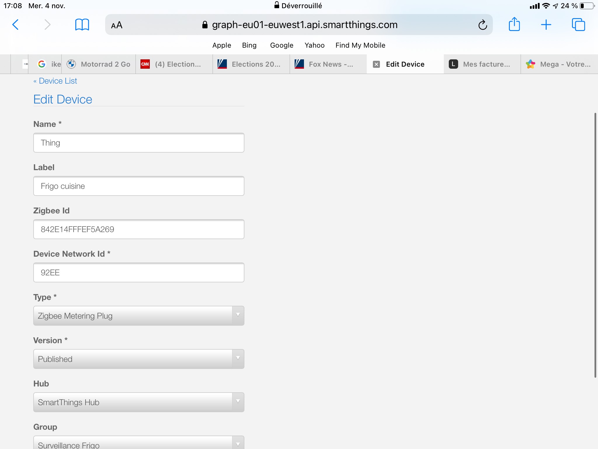

Hi,
I did some tests by changing the type of device in IDE interface and I have a consumption.
Do you know IDE ? => https://graph-eu01-euwest1.api.smartthings.com/
I chose the type of device “ZIGBEE METERING PLUG” like attached file

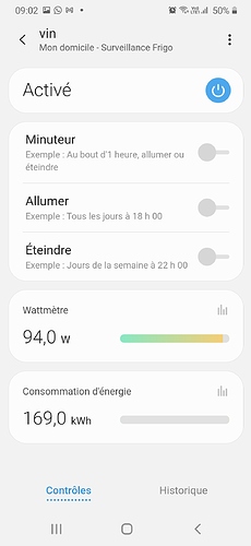

Misters!!! I was trying some of the stock devices at IDE, I found 2 that actually work with at least power measurement!! The first one, because I was zapping them all I forgot what it was, but then, I found another one! So… there are more just you guys to know!! The one I’m using is: SmartPower Outlet
Not the V1 version…
it just show the on/off , plus those timer options and the power meter!!! But that’s fine to me!!!

Hi,
I did some tests
Yes Enjoy
see my screenshot

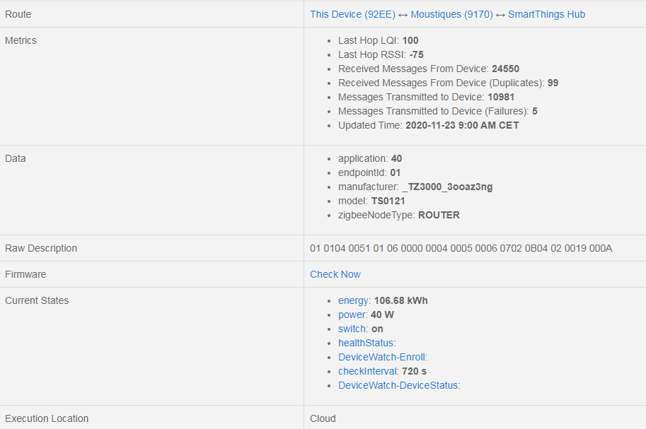

It doesn’t work for me. Could you please check the device details? Mine are:
Data
  • application: 41
  • endpointId: 01
  • manufacturer: _TZ3000_g5xawfcq
  • model: TS0121
  • zigbeeNodeType: ROUTER
Raw Description 01 0104 0051 01 06 0000 0004 0005 0006 0702 0B04 02 0019 000A

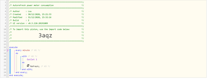

Also! Based on you observation, I made a webcore automation to refresh the state of the device every 30 seconds, that way I have the values right all the time!
Can you please share this webcore piston?
its actually not hard at all, u can change the refresh time, i’m using 1 minute
