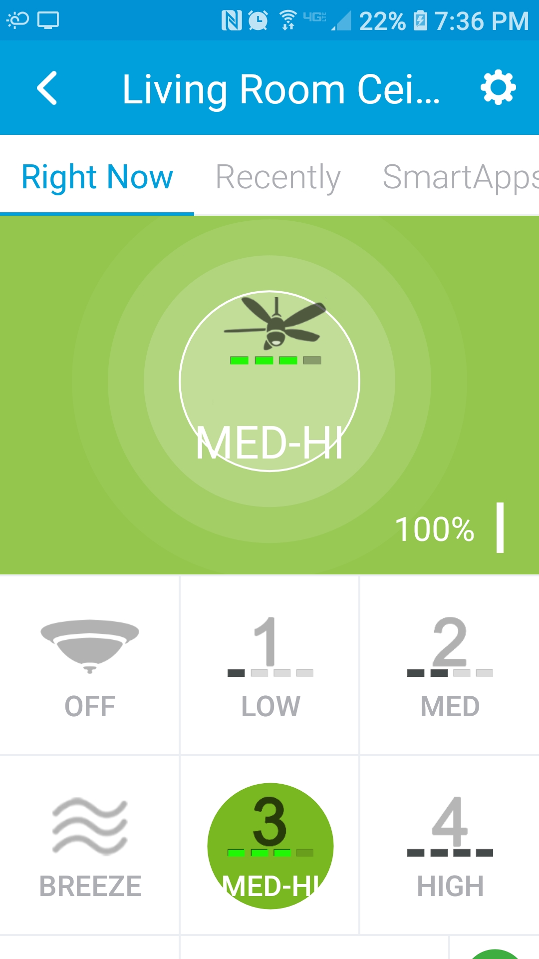

You should only have 2 devices even though you Installed 3 drivers. See screenshots below. This is a device driver, not a smartapp. You can control the fan using automation rules or directly from the 2 devices (one is the light only and the other is the fan controller and light)
