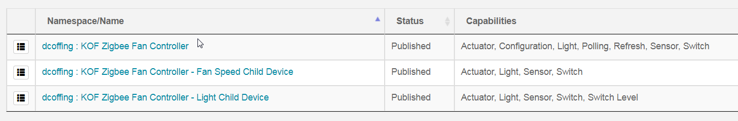

Ok, I got fan receiver/remote and installed it in fan. Couldn’t get it to “add thing” in ST. However, when I turned off my circuit breaker and back on, fan lights three times and ST app found “Thing”. I renamed it to “Ceiling Fan”. On “My Home” it lists it as “Tiles Missing”.
On IDE website I’ve add the three device handlers.
However, it still shows nothing under “My Hubs” or “My Devices”
But my ST mobile app is working fine, so I don’t understand.
Can you point me in the direction of what I’m doing wrong? Thanks
Got it to work. In IDE there are two ways to log on, either with ST or Samsung login. When I logged in with Samsung instead of ST, it showed my device, and I was able to re-add the three device handlers and assign them to the ceiling fan (which did show up on My Devices).
