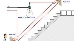

B) are any of the switches used in a setup where more than one light switch controls the same ceiling light? (in the United States this is called a “three-way“ set up. In the UK, this is called a “two way“ set up).

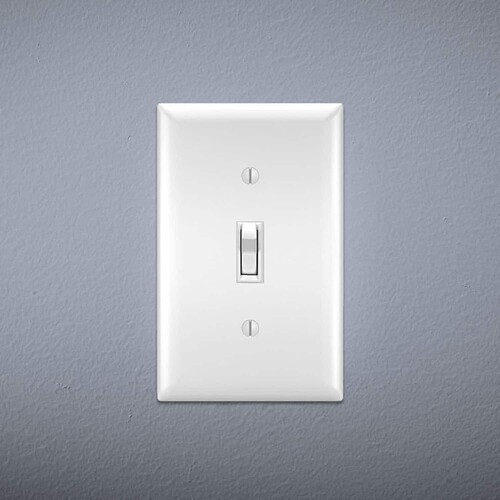

toggle switch (US)

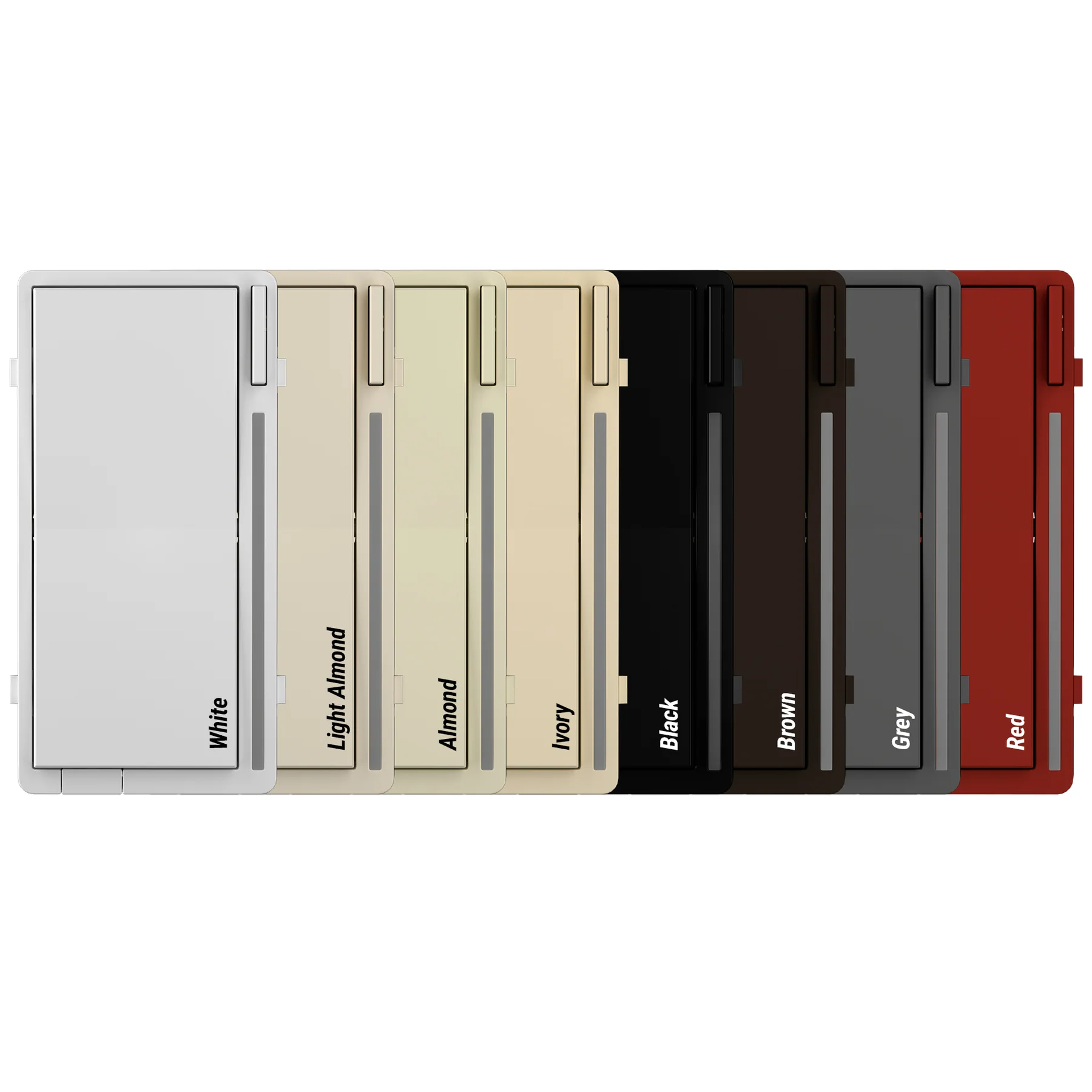

D) what color were you looking for? The most common colors are white and “Almond” (a light beige), but some manufacturers do offer other colors, including black, brown, ivory, even grey and red. But the other colors may be harder to find.

The switch is a 3-way

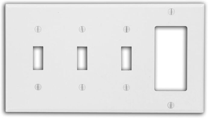

Traditional toggle switches (white) are preferred since it will go on a “4-gang” plate

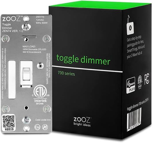

First, if you truly want to keep the toggle-style switch, then you could easily go with something like a Zooz Zen74 smart switch (3-way capable)
But if you want to expand your options, you could just change your face plate.
Given your specific requirements, I would agree with the recommendation for Zooz if you’re ok with zwave. That’s the house brand for the retailer The Smartest House. They are very popular in the community. Standard priced, but with excellent engineering and a lot of advanced features. If you write to their support, they may be able to give you a volume price if you are buying at least 10. (It’s not always available, but it doesn’t hurt to ask.)

One thing we should mention: smart switches are not physical binary on/off switches like a standard dumb toggle switch. So rather than sitting in up for on and down for off, they rest in the neutral position, pointing straight out. Then you flick them up for on and down for off. Otherwise when you use a voice command or automation rule, the physical position of the switch might be out of sync with the state of the light.
Most people won’t care, but some people just can’t get used to the look. So just something to be aware of.
