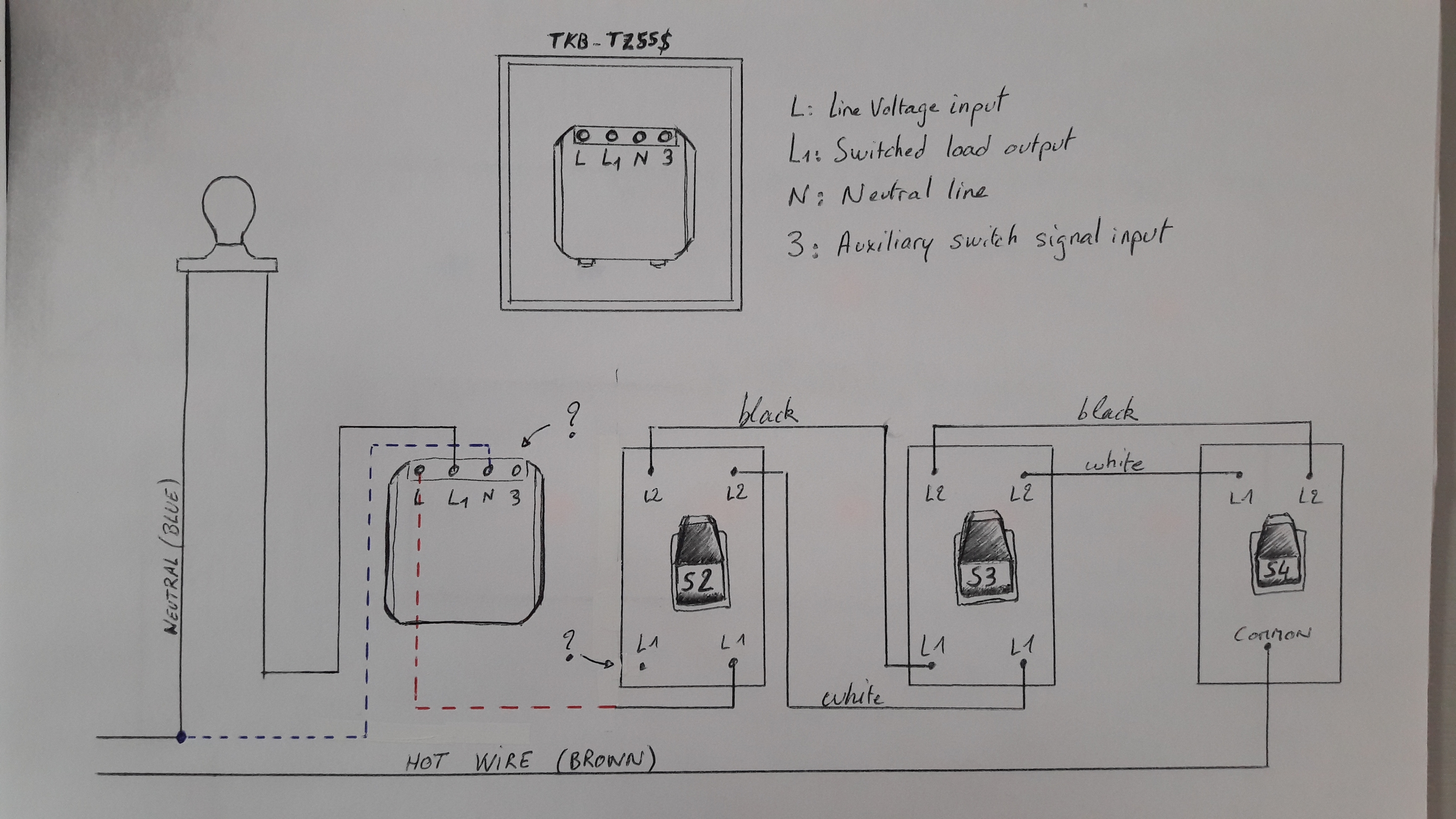

I bought a TKB - Z55s from Vesternet to pilot my corridor ceiling lights, but I’m not a pro electrician and was wondering if anyone could confirm how to connect the wires:

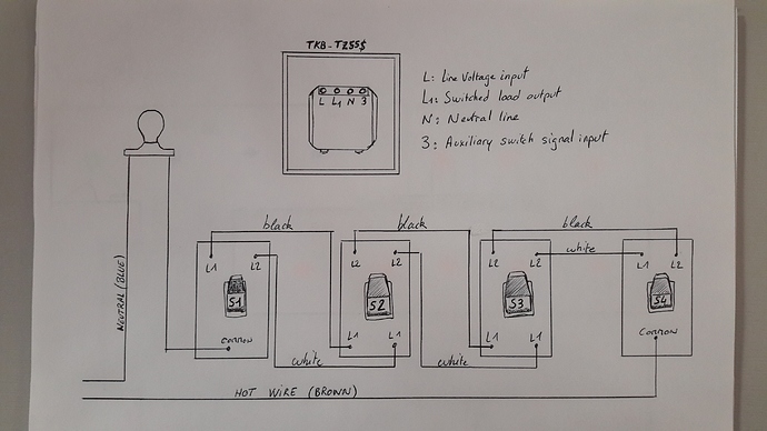

My installation is as follow (4 switches S1, S2, S3 and S4)
As far as I understood I have to replace Switch S1 with My TKB switch ?
Given the TKB guide:
Am I good to think the connection should be as follow:
But then what is the use of plug “3” auxiliary switch signal output ?

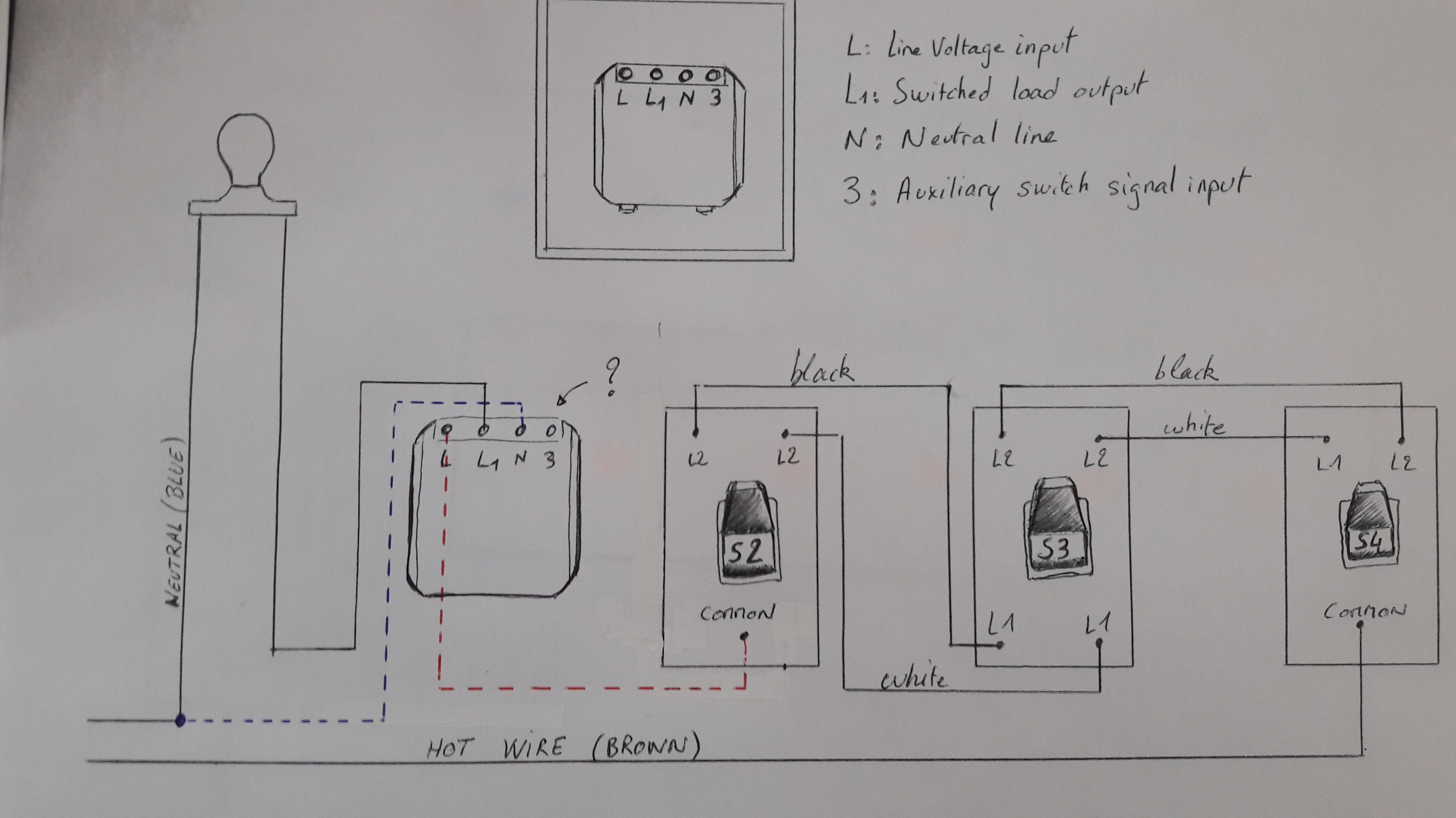

And what with the second L1 output of switch number 2 (S2), or should I replace S2 by a 3 way switch resulting in the following ?
No, the lamp to the device is correct but the live cable (should be brown in the UK) goes straight to L, not vira the switch.
Then one of your common points will go to the auxiliary switch input then the other think of it as the live to the switch but IT IS often NOT LIVE! It is normally 0v and will be connected to ground. But I can’t find the information for this product to be sure, if you could post it I can help further. BTW I’m a electrician and a lighting controls engineer.
Edit : I’m also referencing to the last photo the one before has only one 2 way switch (3 connection switch). You always need 2 for 2 way switching then if you need more you use the intermediate switch’s in-between (the 4 connection switch).
There is also another way to connect 2 way switching if your live and switch line in in the same box.
Hi @borristhecat, thank you so much for your answer:
here’s the link to the pdf from TKB website: http://www.tkbhome.com/upimg/file/1202365814088.pdf
I updated the diagram according to your explanation, let me know if I misunderstood what you meant
Again thank you !
Yes and no, just had a look and it not the type of switch I thought it was and also not the type you thought it was. What you want to do isn’t possible by the looks of it (there is a way but it’s not very good and you could have your light off when smartthings says it’s on). This is an all in one single switch, you could create 2 ways but you would need one of these per switch by the look of it (this is why I couldn’t find the other common terminal). What you want is a fibaro switch or Aeotec nano then seperatly some DUMB retractive switches that way you can create 2 ways without the cost. As per the information at the beginning of this thread.
Ah crap ! Thank you for spotting this out, I was a bit naïve thinking I only had to replace a classical switch with this one would work…
Yes, @borristhecat is right, to use this switch with external switches (ie the rest of the circuit) you would need to swap each of the extra switches with TKBs auxiliary module - which seems to be a branded simple 3 way retractive switch. If you don’t want dim up and down at the switch then you don’t even need to change your switches (but dimming is then only possible via your phone or automation rules - which may be enough)
I have wired my switches as per the diagram, but the landing light which is connected to TZ56S is receiving a input on terminal labelled “3” from the downstairs hall switch TZ57, but the light on the landing light switch does not respond to the Aux input been received from the hall switch output.
Any ideas.
Sean
the diagram is wrong, if you read the messages it won’t work like that
Ok thanks, any recommendations on how to get it to work electrically, sorry to be a pain.
Sean
I can give you a few but there all rubbish with this device, the way to do it with this device is replace all your switches to this switch. This will obviously cost more than using a different type of device (i.e fibaro dimmer) that will do what you want it to do.
