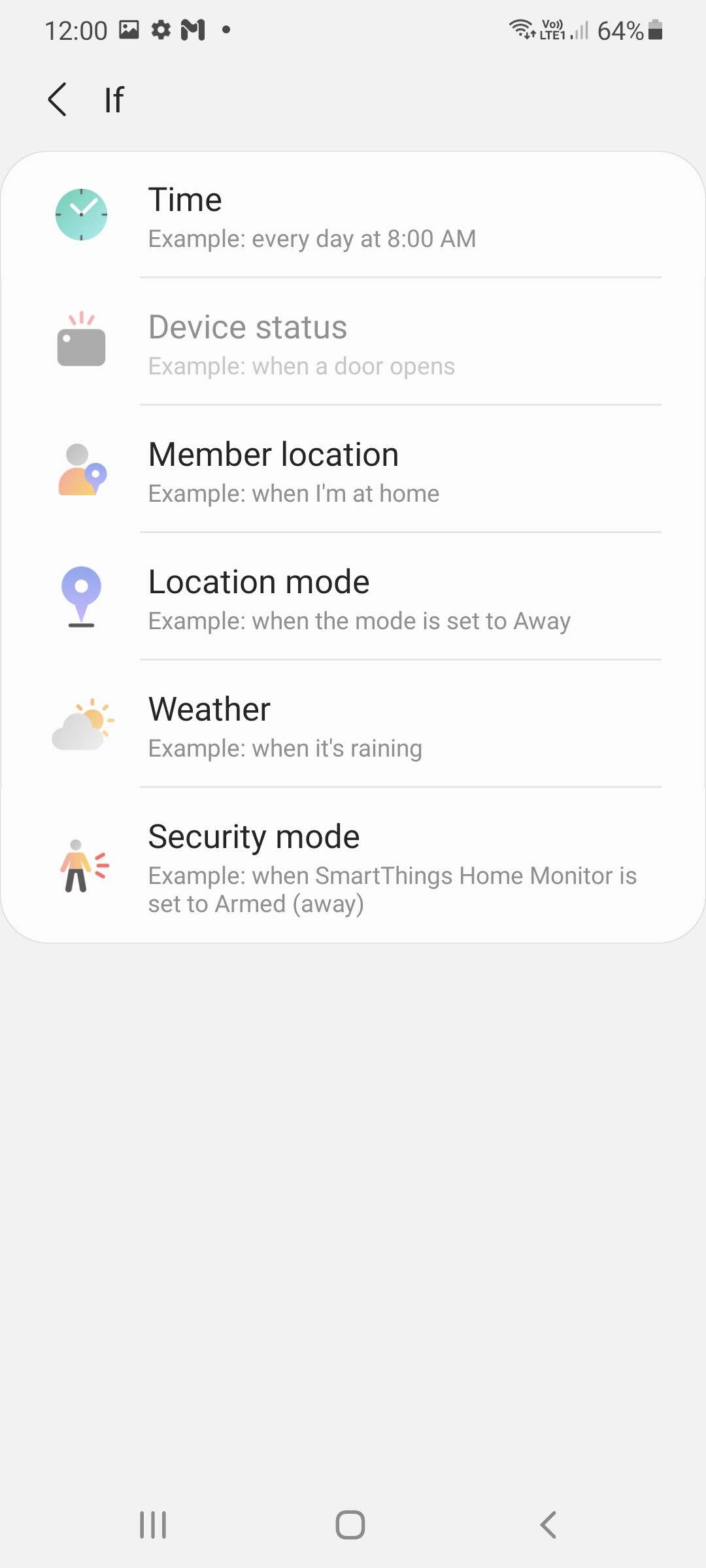

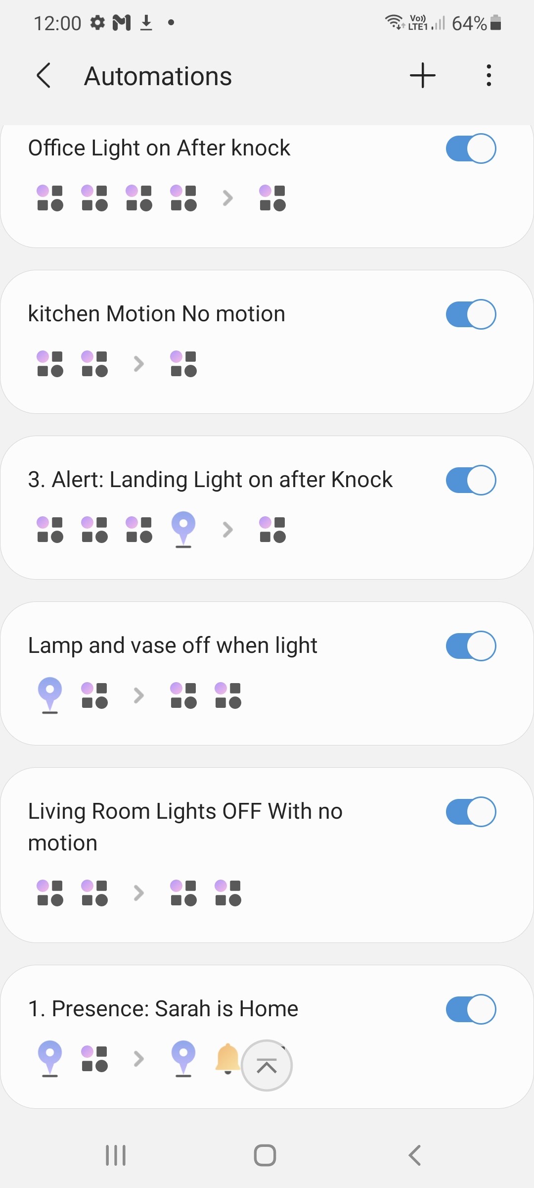

Woke up this morning to find most of my devices in Automations and Scenes show as Unknown D evices.
When trying to add a device to an automation the “Control Devices” option is greyed out, also the same for adding devices to scenes
The same devices still show within all other areas of the app/IDE.

Screenshot_20210212-053712_SmartThings|165x500, 100%
Has anyone else ever had this, I have tried everything,
I cannot create/edit scenes or automations

There is an internal ticket for that fix - and the fix is in a testing environment at this time. It looks like you have a device that uses components that are not unique - most likely a multi button remote of sorts - it defines button1 and button2 twice as components - that’s what is causing an error that is preventing the phone from getting the list - as far as why another phone works, I can only shrug harder. :smiley:
AHH ok that makes sense I have 4 IKEA Tradfri On/Off switches and 1 IKEA Tradfri 5 button remote which all have pressed/held functions on buttons with component names like “buttons”
