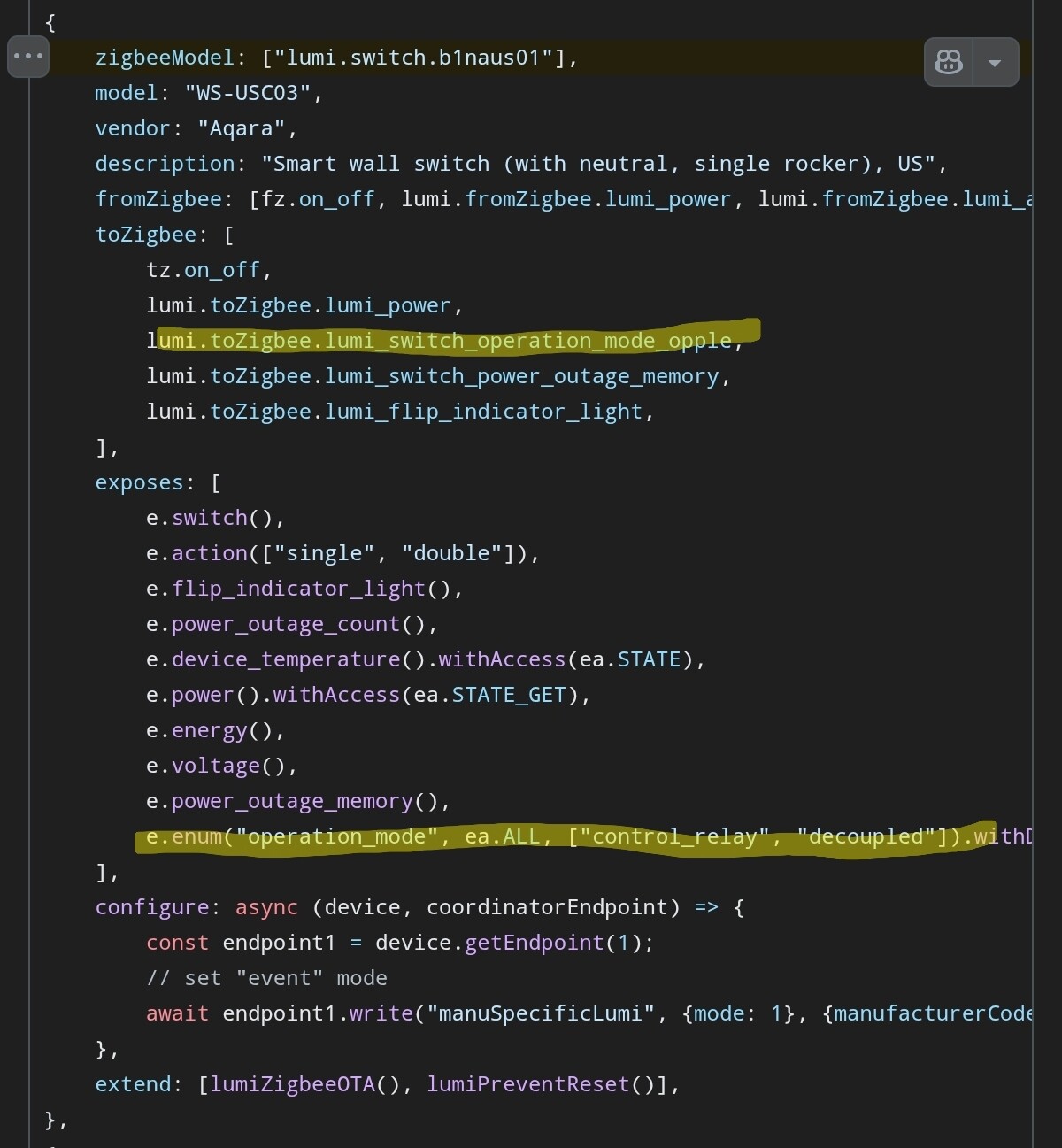

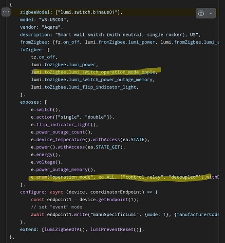

From ZHA:
Edit: the driver supports this feature, but not for your model:
@Clell_Britt post a feature request in this thread:
Tagging @veonua .
