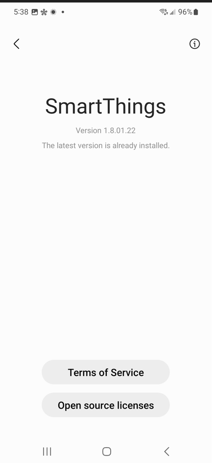

<img width=“206” height=“447” style=“width:2.1458in;height:4.6527in” id=“_x0000_i1044” src=“//cdck-file-uploads-global.s3.dualstack.us-west-2.amazonaws.com/smartthings/original/3X/d/d/ddfa334901de7c7fce2f7b54f999ae64f7203322.png” alt="A screenshot of a phone
Description automatically generated"><img width=“204” height=“446” style=“width:2.125in;height:4.6458in” id=“Picture_x0020_1” src=“//cdck-file-uploads-global.s3.dualstack.us-west-2.amazonaws.com/smartthings/original/3X/6/3/634417799317b243844e1811e4696130e5669c2e.png” alt="A screenshot of a phone
See section 8 of the community FAQ on edge drivers:
FAQ: I have no idea what Edge is. Is that a new developer tool? (2022)

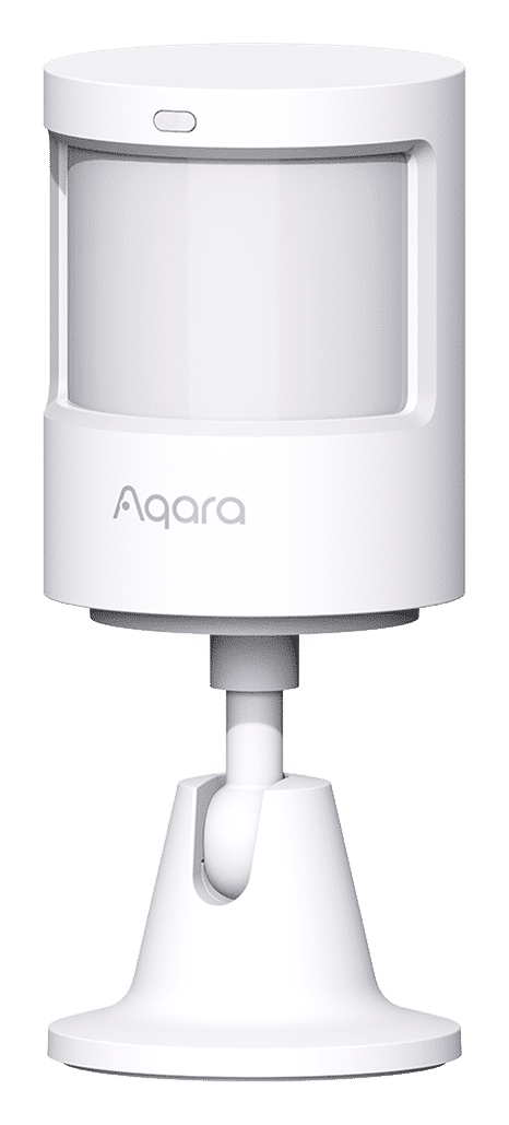

So now is an Aqara Motion Sensor you are trying to add? I thought we were discussing about the Precense Sensor FP1, do you know what is exactly your device model?
I am very sorry about the wrong part number
It’s an Aqara P1 Motion Sensor
