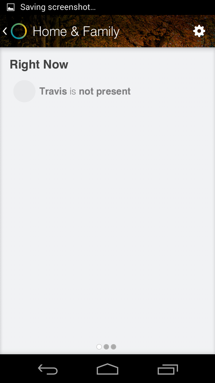

My android presence isn’t working at all… Nothing. It always says I’m away, regardless. I’ve tried re-installing the app, and some of the other things mentioned here (force closing the app).
The GPS is working, Life360 is working fine and detecting when I’m home/away no problem.
