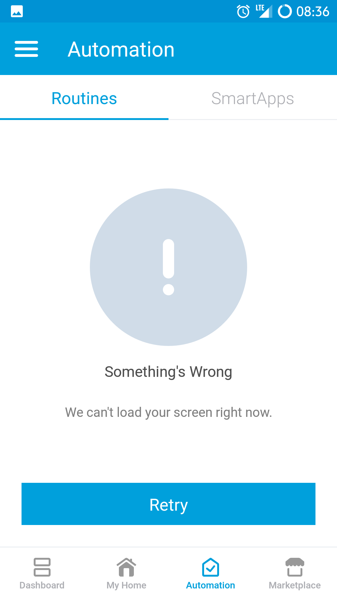

Getting errors trying to edit rooms, and dashboard fails to load. Started happening today
Screenshot_20180201-223329
Also getting this frequently since recent ST app updates on Android.
SmartThings needs to look into this…pretty annoying.
Also getting this (wasted hours uninstalling new Things trying to identify the cause).
Also when I try to open individual Things from the My Home screen it starts to open the Thing screen (slides in from the right) then returns to the My Home screen.
Identical behaviour here too . Something isn’t right.

Well, having the same issue here since today. Typically the error message displays when coming into the “Things”-tab. I’m on eu01-euwest1 but can occur wherever
Android device/os version is most likely not the culprit since i have the same issue on my Galaxy S7 with Android 7, and my Lenovo tablet with Android 6. I also noticed that the Lenovo app still was on 2.13.0 and my S7 on 2.14.0 (updated yesterday) so conflict between app and new hub firware seems most likely
