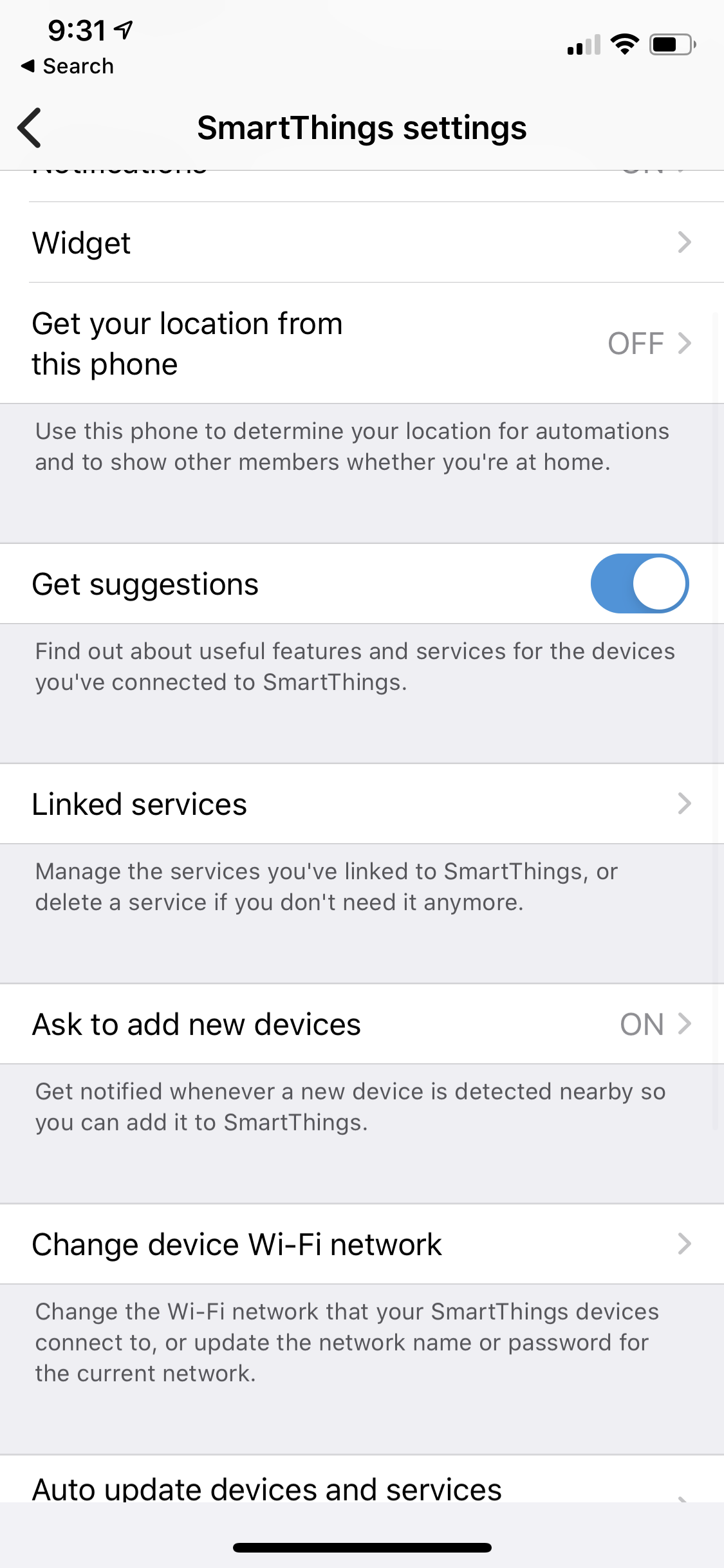

First, thank you for this topic. I thought my Alexa app just had a fluke with my duped devices, but @JDRoberts’s explanation made sense and I was able to figure out what he meant in post 2.
I had to go digging, but apparently it’s in the settings. So (gear icon) > Connected Services > Amazon Alexa. From there, you can “Allow Alexa to access all devices, Scenes, and Routines”. Turn it off, and you can select which individual things you want Alexa to access.

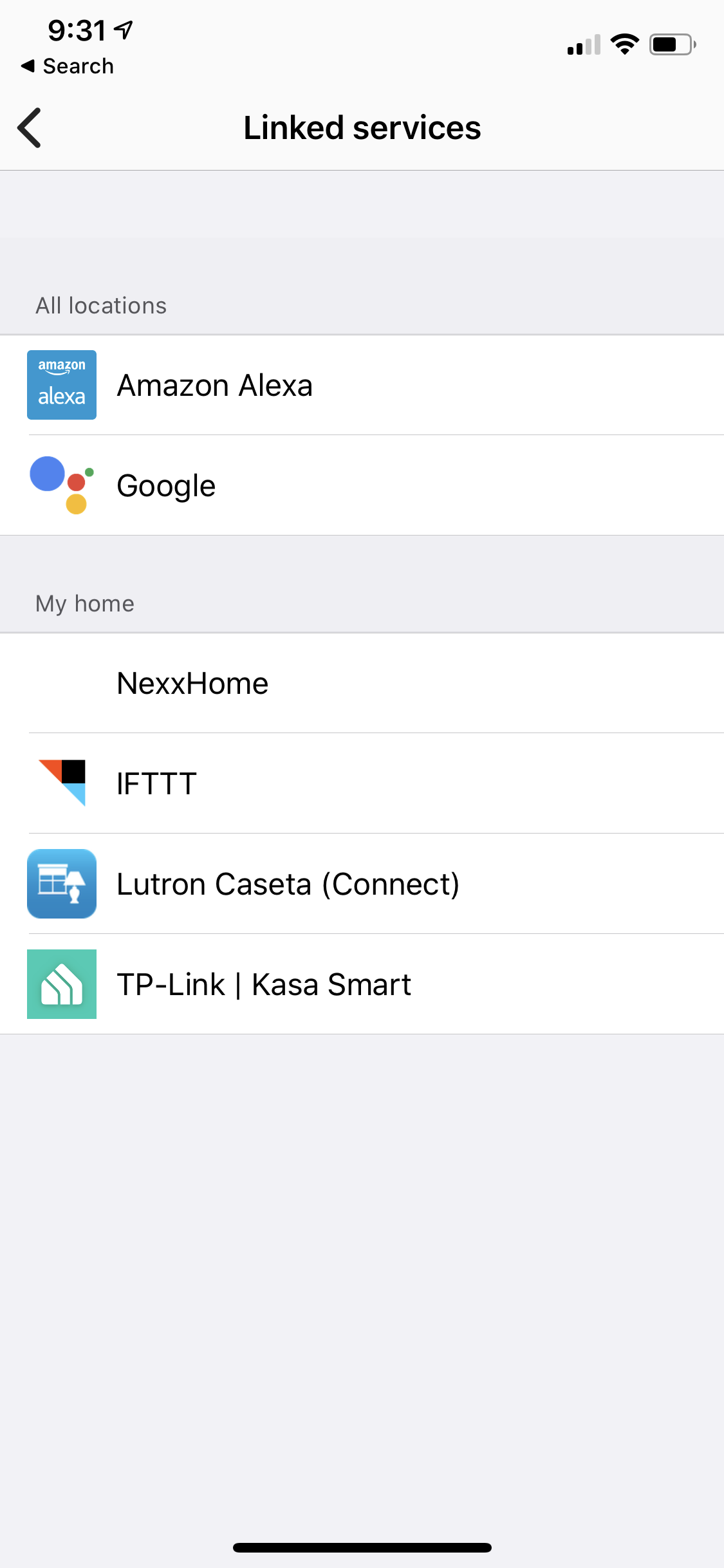

Are you referring to the new SmartThings app? I don’t see it in my app.
Yes I see it in the new app… if you click the gear icon in the menu on the left “Connected services” are listed in there…
I hope that’s what you meant :+1:

The instructions for new smart things app don’t work. You click on Alexa and it just shows an icon and a button to delete / unlink. No way to control what is shared.
Any ideas or knowledge on a modern approach?
Unfortunately, this changed about a month ago when a new Alexa skill was released for SmartThings and you can no longer choose which devices are exposed to Alexa. It’s now all or nothing. (The same issue was introduced for google home at about the same time.)
