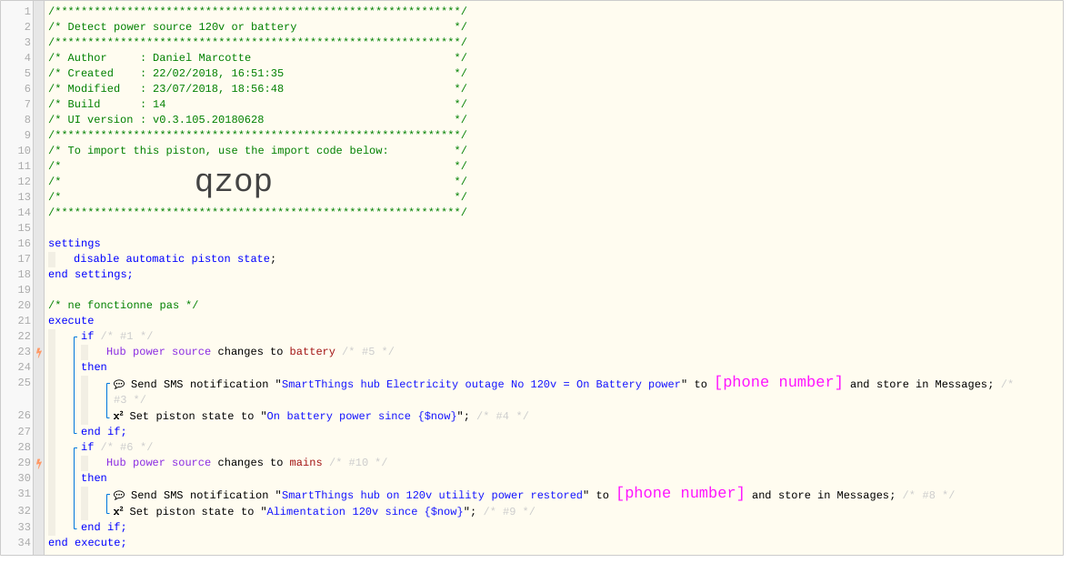

An other way to send the alert is to use the TEST button in my piston, it send the actual state.
Picture of the test piston
Picture of the piston i’m supposed to use every day

I figured that I would finally take WebCore out for a test drive. So my first attempt was to try to use this ā€˜Hub Power Source’ feature with my V2 Rev E Hub since Samsung SmartThings doesn’t have any support for the battery status whatsoever. But alas, it never worked automatically no matter which examples I tried using above and from the WebCore forums. I even tried the WebCore dev repo, but it still didn’t work at all. It only worked when I would open the WebCore SmartApp Dashboard and just select ā€˜Done’ and ā€˜Done’ again to close the WebCore SmartApp that it actually fired the alert. Funny thing is, I could see the little battery ICON appear and disappear inside the WebCore app under the Hub ICON everytime I pulled and reconnected power to the Hub, but this Hub Power Source feature failed to do anything at all.

Nevermind, I figured it out. When I switched to the Dev repository, I didn’t save and republish the code to myself. So I’m now using the WebCore Dev repository using the bx8y8 code that has ā€˜changes to’ with a tweak from SMS to Notification and it instantly sends me the notification. Nice!

Jrfarrar’s code (4z3m) does not work for me. Like others have reported, I can see the battery status on the Dashboard, so webCoRe is seeing the battery status on some level, but this piston simply does not work. Interestingly, when I test the piston (with the Test button, not by actually pulling the plug to put the hub on batteries), I always get a ā€œnow on MAINS powerā€ notification after the delay (I changed it to one minute to make testing easier), whether the hub was on battery or mains when I initiated the test.
