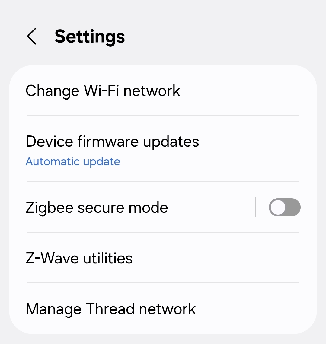

You can make Fibaro Roller Shutter 3 Z-Wave Exclusion using Aeotec Smart Home Hub.
Start using SmartThings App open Aeotec Hub Detail View and from top right three dots select Settings.
Select Z-Wave utilities
When Z-Wave exclusion is started quickly, triple click the S1 switch

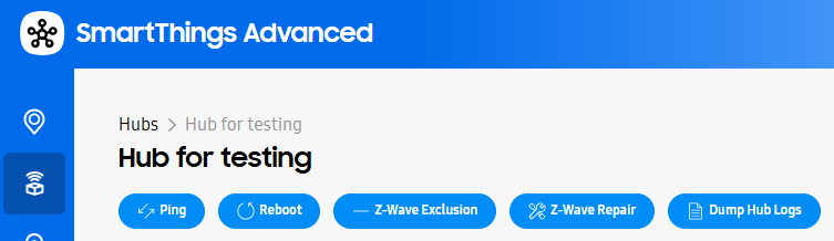

Z-Wave Exclusion can made also using SmartThings Advanced
