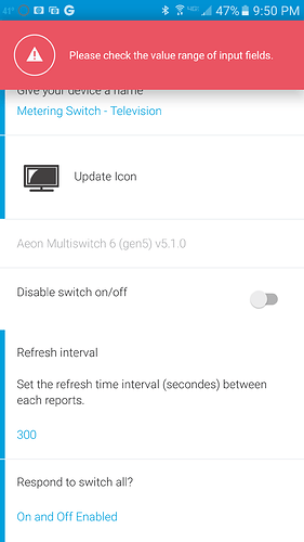

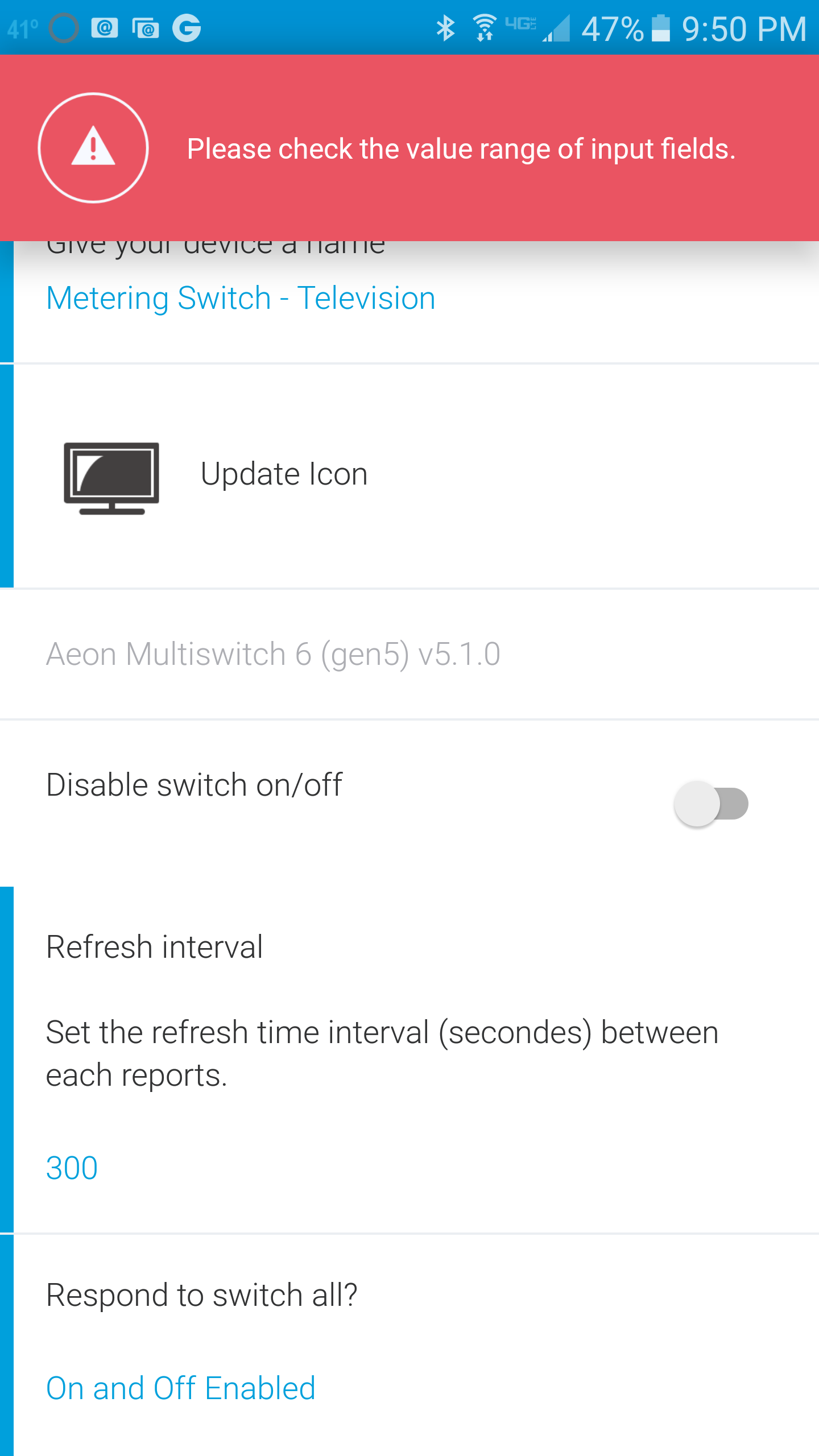

There seems to be a problem with the configurations page. After including the device, if I go into the configuration page and try to change something, I get this error. Sometimes I can make one change before I get the error. Even if I go into the configuration page and do not make any changes, just click Done, I get it. I have tried multiple exclusion and inclusion and still have the same problem.
yeah…I just fixed the issue I think now, if you update, I believe everything should be fine now
That seems to have done it. It appears to be working just right now. Because of your DTH, this will be the metering switch I will be purchasing in the future when I need more.
