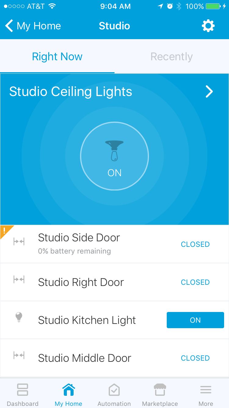

I have one of ten Aeon Gen5 door sensors that is working fine with fresh new alkaline batteries, but the iOS app and the website report 0% battery and it is flagged. I have rebuilt the z-wave network, rebooted the hub, removed and replaced the batteries in the sensor multi time and still can not clear the error.

I figured out what the issue is… in the configuration of the sensor there is a parameter that tells it to send battery status. It is parameter 101 and the default is 0 (disabled). I hacked @jabbera’s DTH to force it to send a 1 for that parameter when the sensor notifies the hub it has awaken. I then pressed the button for 6 seconds (until it starts blinking and no longer) to force it to wake up and bingo, I saw updated battery readings in the live logging for the sensor!
