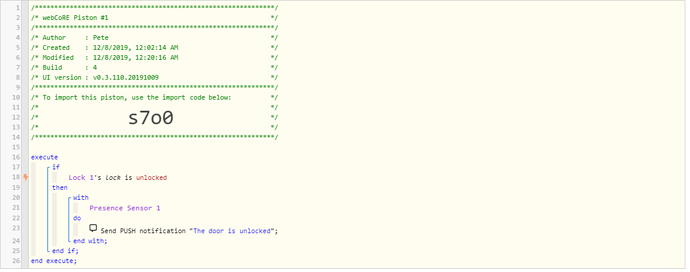

I’m trying to put together a piston which will send my phone a push notification, if my Conexis L1 lock is left unlocked for 10 minutes.
So far all I’ve got is…
Which is missing the whole ‘10 minutes’ thing - and I guess i’ll need some way to cancel it, if the door is locked?
Thanks!
if lock’s lock stays unlocked for 10 minutes
then
with
Location (use location instead of presence sensor 1)
do
send push notification and store in messages “The door is unlocked”
end with
end if

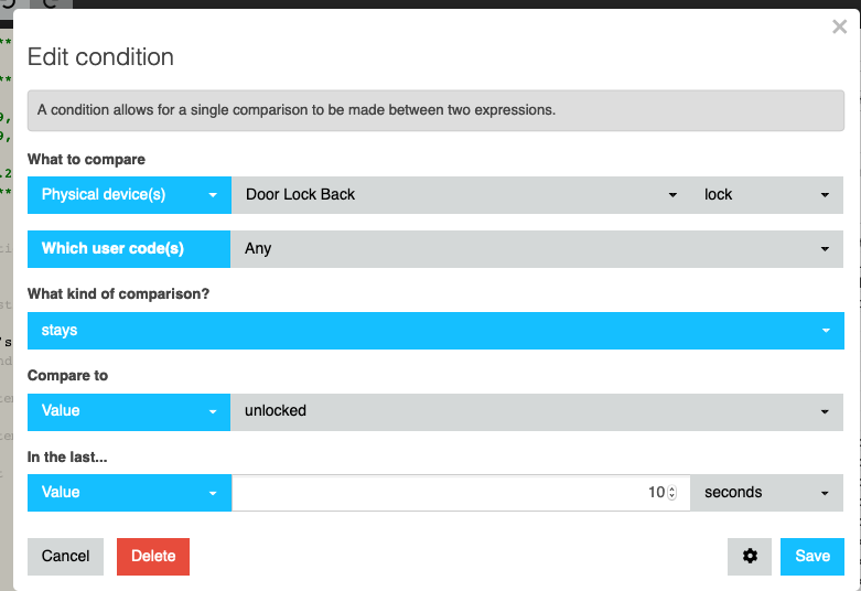

anyway, simple piston to get you started. if you want more advanced, look at example pistons on the webcore forum :slight_smile:
I don’t under how i would write the ‘if its unlocked for 10 minutes’ part?
my image shows10 seconds so change to minutes
Perfect! Thank you!
