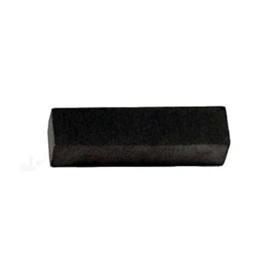

My concern is that since the magnet is round that it could potentially roll off the adhesive. I purchased the magnets in the above link and will see if they do the job just as well.
The magnets in my daughter’s magna-tile sets would probably be perfect - about 1/8" square x 1/2" long and strong enough to build reasonably sturdy structures…something like this is pretty close but your selection is a little more cost-effective since this is only 1 piece.
