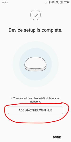

How are you trying to add it? I have the ET-WV525 (Plume) and if you want to add an additional hub, you need to add it as a sub-hub from the primary vs adding it via “+ Add device”.

The screenshot I posted was from the ST mobile app, not the Plume app. I was giving it as an example of adding a sub-hub vs adding a completely new separate hub. If it works similar to my model, you should be able to click on your primary hub and somewhere in the device card there should be an option to add a sub-hub. For my model, you click on the primary hub and then click on Network Status and then there is the option to add the sub-hub as I posted.

If your new one does have new enough firmware that it can communicate with SmartThings, you used to add a new sub by starting from the device screen for your main hub, and then selecting the “add another hub“ option from there.
If you are being given the option to set up a new network, it sounds like you started from “add a device“ and then chose hub. But that’s not what you want to do in your situation. You want to start from your existing primary hub, and there should be an app option somewhere in its device details to add an additional sub hub. :thinking:
