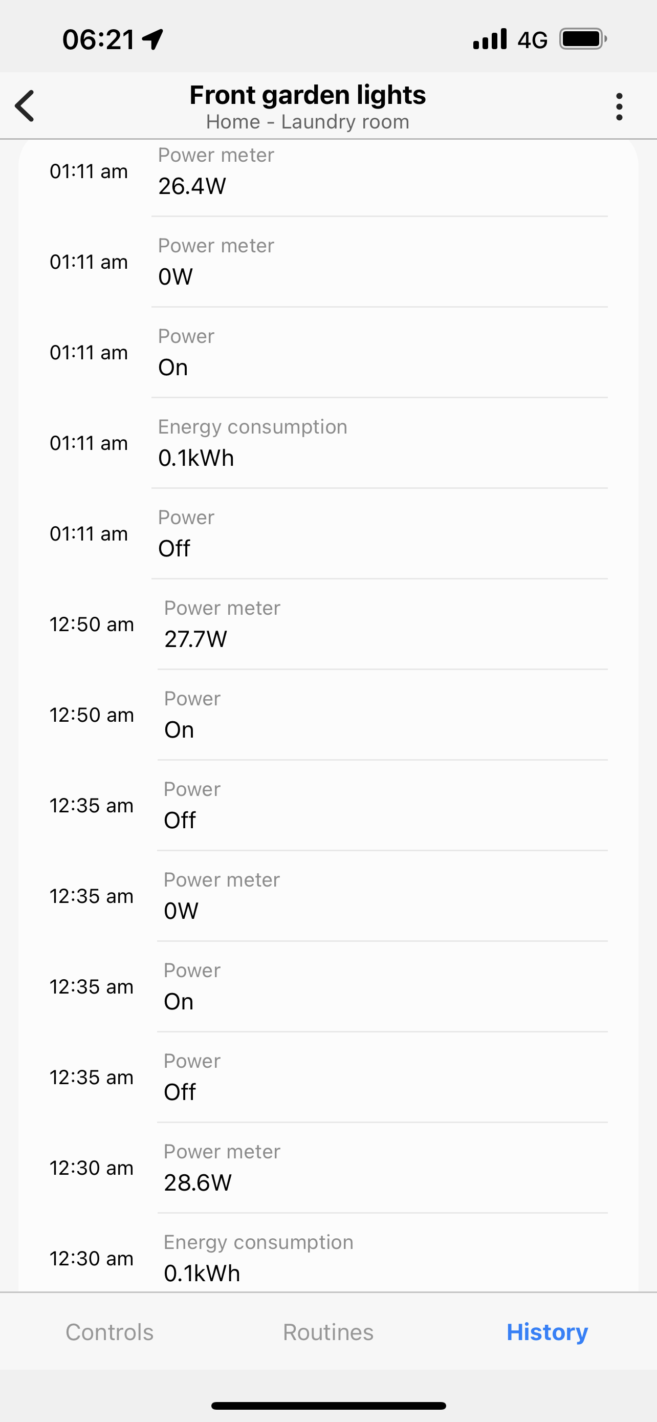

I recently installed one. When I switch them off, either on SmartThings app or physically they go off then they come back on a second later. Other previously ones still work fine! Any thoughts?

Looks like you may be right it is hovering around 25 watt level
