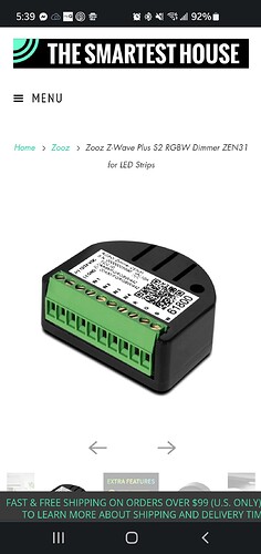

There won’t be a custom Zooz driver available for that device by 9/30 and I’m not sure how functional the built-in driver its assigned will be.
I think someone created a custom driver for the Fibaro RGBW controller, which is almost the same device, and added Zooz’s fingerprint to it, but I’m not sure how functional that is either. I also don’t remember who did that so you’d need to search the forum.
