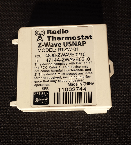

Yes… it may need one of these.

I bought a refurbished thermostat (don’t have the model number handy, but will try to dig it up) which had a “blank” inserted into the place where the optional USNAP module goes.
It’s quite possible that CT100 model has the USNAP permanently built-in, or included by default; but it may, like the variant I have, be an optional add-on, or removable / swappable.
EDIT: @jwindsurfer: The Amazon page for the USNAP module only lists compatibility with these 3 lower models, so I’m guessing the CT100 has Z-Wave internally hardware included.
Compatible with CT30, CT50, or CT80 thermostats
Just to update. Received my CT100 a few days ago. Installed it without a hitch. Does not require any additional module. The note on the “Works with SmartThings” is obviously an incorrect hold over from the previous version thermostats. The Z-Wave support is built into this version and not an option of any kind.
