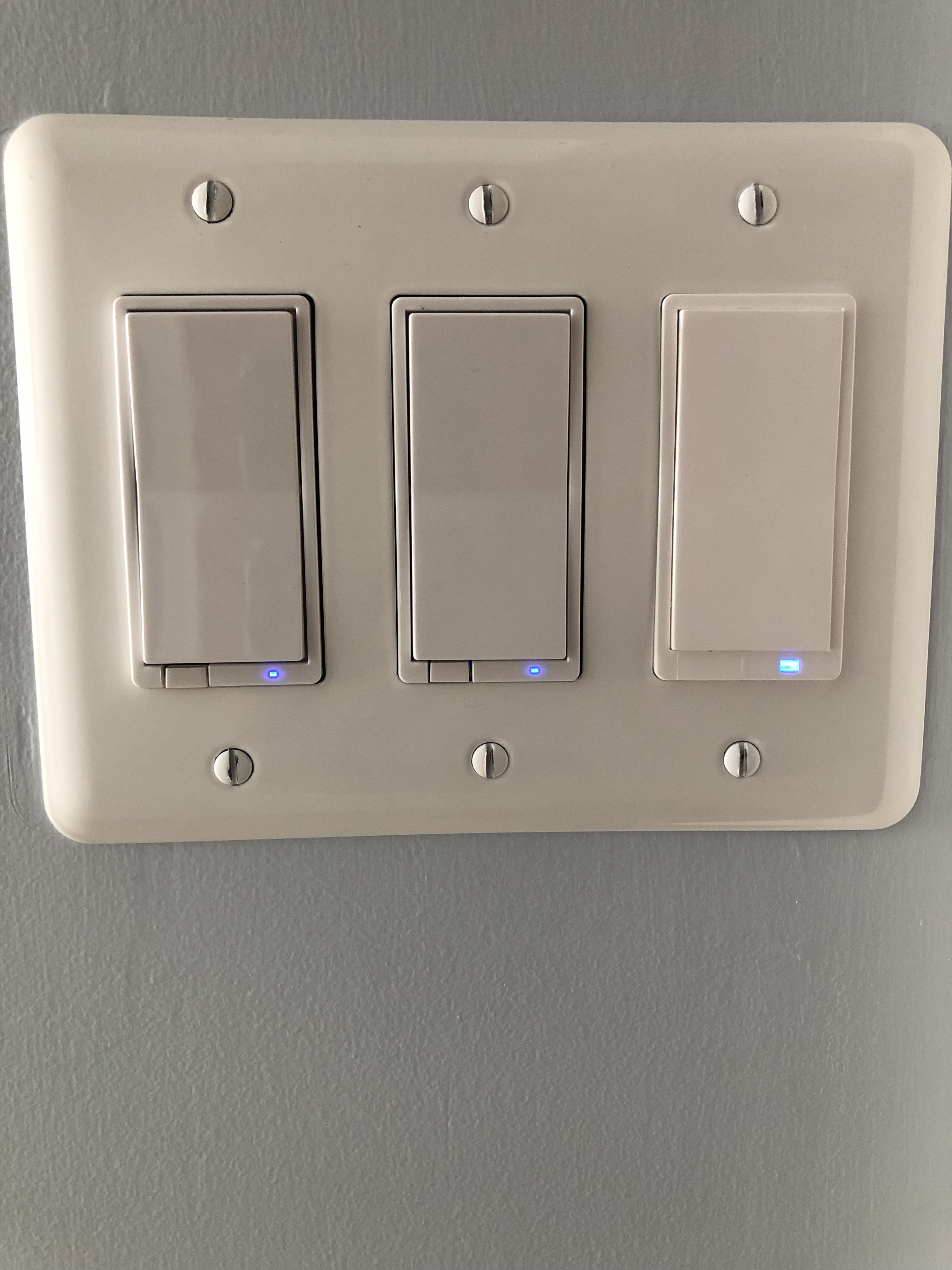

You can probably use the GE fan switch and it will look very similar to the zooz rocker switches. Not identical, though, so it depends on exactly where you are using it.
The Zooz switches are a brighter white than the GE ones - at least the older models. If I remember I will post a picture tomorrow as I have one of each in the same gang box.

Finally following up to my post about color differences in case anyone else comes across and interested. The left and center are GE and right is Zooz. Noticeable difference.
