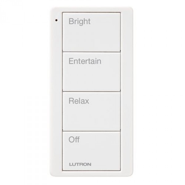

I once stayed in an Airbnb that had Lutron switched before I had any idea what they were.
They were slow enough that I couldn’t tell what each button did. Some of the buttons had been broken so function of each was not obvious.
Bottom line, it was a mess trying to control the lights!
