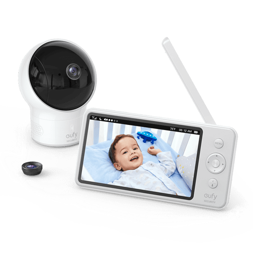

Zwave is on a different frequency, but it’s the same frequency that was used for purposebuilt baby monitors for 30 years, or some of the old style cordless phones. Again, people typically have had these in the room with babies for decades. ( well, not the same baby obviously, but you understand what I mean. :wink:) So older non-video baby monitors are frequently on the same frequency as zwave and the video baby monitors are usually on the same frequency as Zigbee.
